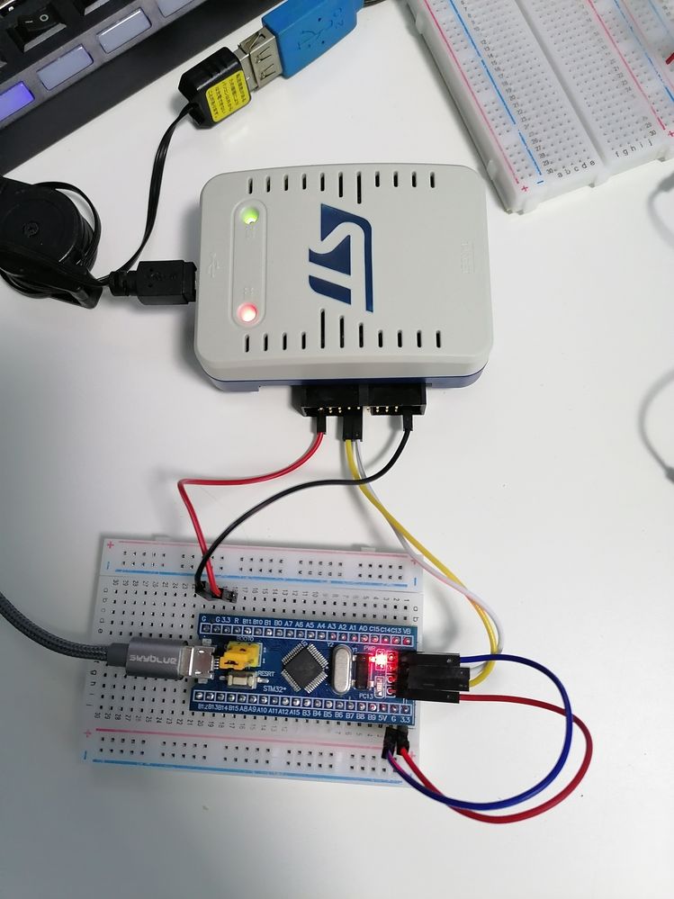

Anyone here successfully connected STM32F103C8T6 clone board using ST-LINK V3SET ?
QUESTIONS:

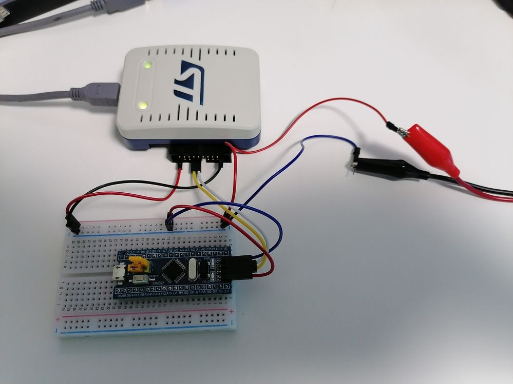

1. Here is the pins connection layout using CN2 JTAG:
+5V external ----> T_VCC pin 1
GND ---------------> GND pin 20
SWDIO ------------> T_SWDIO pin 7
SWCLK ------------> T_SWCLK pin 9
The actual connection is like below:

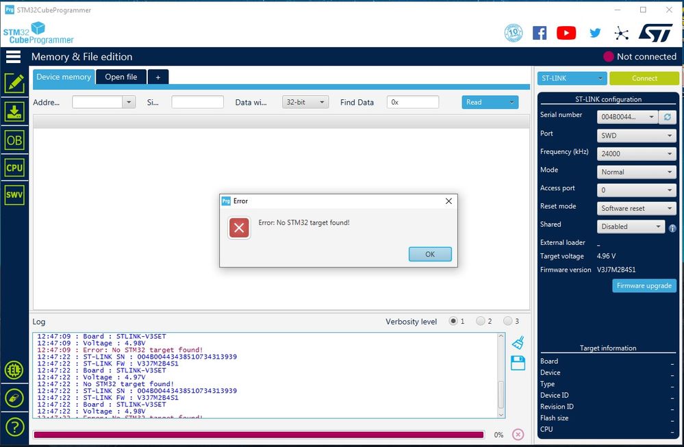

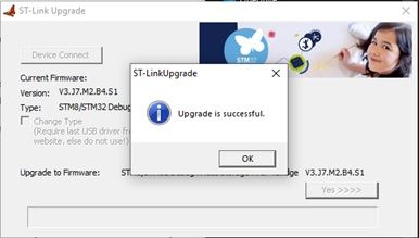

STM32CubeProgrammer already upgraded to latest ST-LINK V3SET firmware V3.J7.M2.B4.S1,
but I am unable establish connection to the STM32F103C8T6 board as shown picture below and the STM32CubeProgrammer CANNOT BE CLOSED:
I have reset by pressing the RESET button ( Software/Hardware reset options selected ) then followed by clicking the Connect button, the result still the same as shown above, any idea ?

VTarget of 5V is clearly inappropriate, thing should be running at 3 or 3.3V
https://stm32-base.org/boards/STM32F103C8T6-Blue-Pill.html
There should be a 5V supply pin you can use on the board. Connect that up, and then the Pin 1 of the SWD header should be at 3V3, and you can use that as VTarget (Pin 1 JTAG)

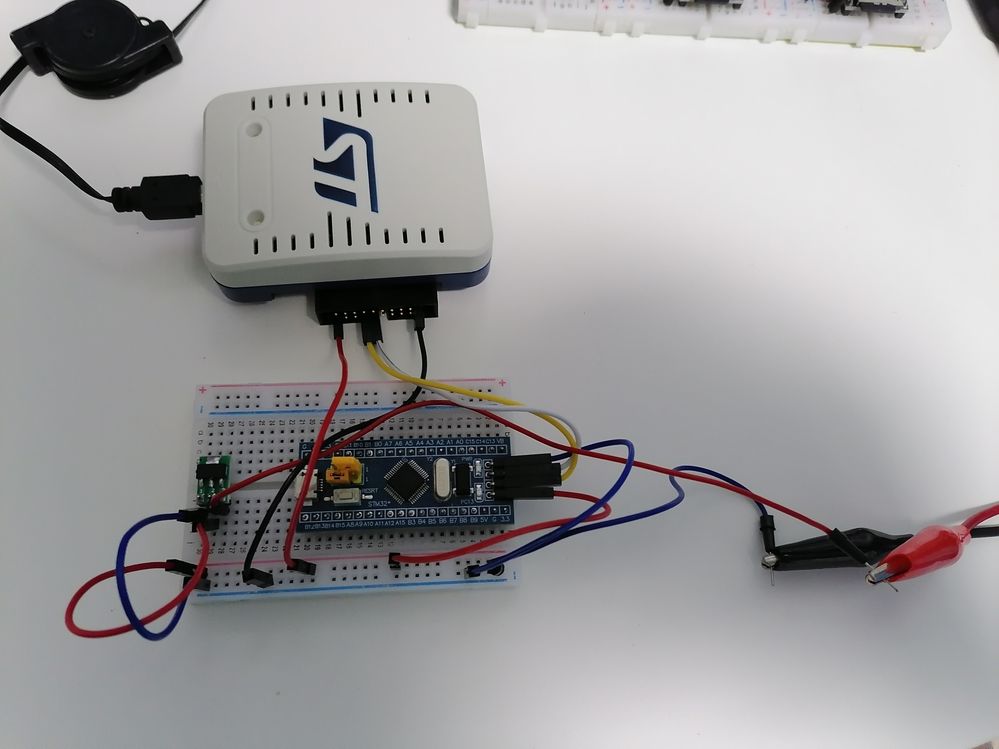

Yes, I did tested it using a MC33269 3.3V Voltage regulator as picture shown below, the SWD interface of STM32F103C8T6 is 5V tolerance input which I have tested it using +5V from ST-LINK V2 before:

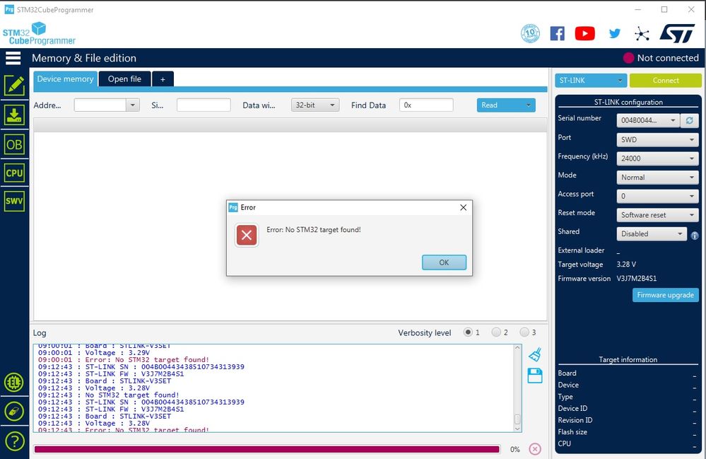

Seems.... my setup above, is using the output +3.3V from Voltage regulator to drive both STM32F103C8T6 and ST-LINK V3SET JTAG but still failed.
Please advise.

Bluepils often have STM32F103 clones. StlinkV3 denies active to work with those parts.
hi Uwe Bonnes, thank you for the feedback, I just received information from "S C ( ST Employee )", the support also said so, it could be clone STM32F103 is not supported by STLINK V3.
Stlinkv2 does not do that check when using SWD. Perhaps you have some disco or nucleo board and use them to attach,
yes, I agreed with you, only if the firmware of STLINK V3SET remove the checking routine, only then I believed, it can works on clone STM32 chips. Thanks again for sharing the information, much appreciated. :thumbs_up:
