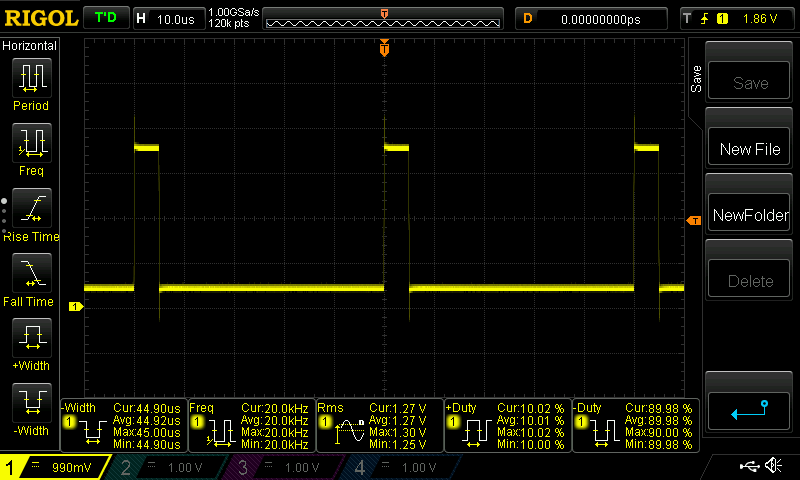

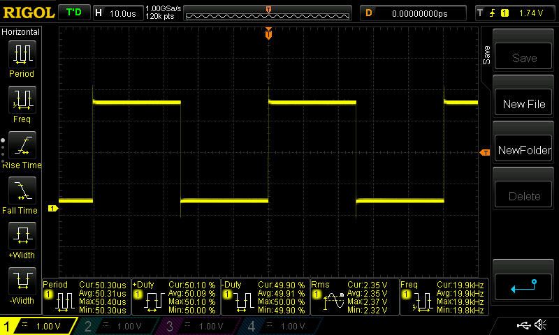

hi dears .
i am trying to use toggle mode in stm32f103re with IAR and cmsis.
When do i set  TIM_ClockDivision  in my code , the duty  is 50% , but i know i set the Compare4 to other value in time base init , and it does not be 50%.
And when i put this line to comment, the code do correctly.it does not be 50% duty cycle.i see that with oscope.
i dont know why this activity occer.
the register in default mode has 0x0000 value , and when i comment the line of set clockDivision , it has zero value,and if i  uncommented this line and set to zero , the code do the activity wrong.why??
i mean this line:
TIM_TimeBaseStructure.TIM_ClockDivision = 0;
this is my code with the uncommented line that there is above:
thanks alot.

    yeah , got it.
    but when is do that, i think the toggle mode dose not work.
    i mean , when i set a value to CCR4 register :
      TIM_OCInitStructure.TIM_Pulse = 30;
    however i have 50% duty cycle in a period.
    the period value is 200 and i know that  is wrong in toggle mode,but when i comment the line TIM_ClockDivision , the toggle mode work correct.
    i think when the timer value = pulse  then toggle happent.
    but here toggle happent at half of period always.
    when TIM_ClockDivision compile with other line.
    when TIM_ClockDivision not  compile with other line.and in my idea this activity is true in output compare mode toggle.
    thank you.
