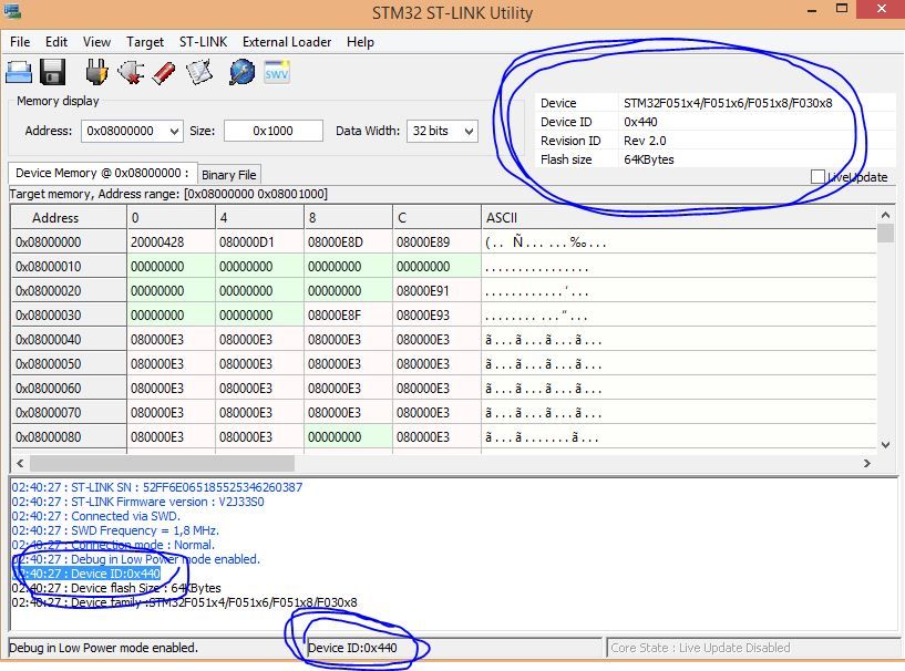

When I connect my device via ST-Link program it shows something like below. It maybe what you looking for.
Do a hash of the Unique ID
But that's the same for every part on the tray...
The OP is talking about getting a unique number that is a subset of the 96-bit Unique ID as that's not random, just guaranteed to be unique for each die produced
