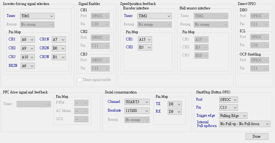

I follow Motor Profiler to set my board, and I check my pin map with my motor.

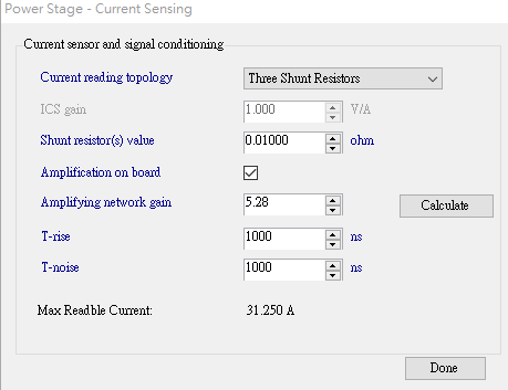

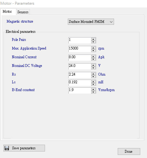

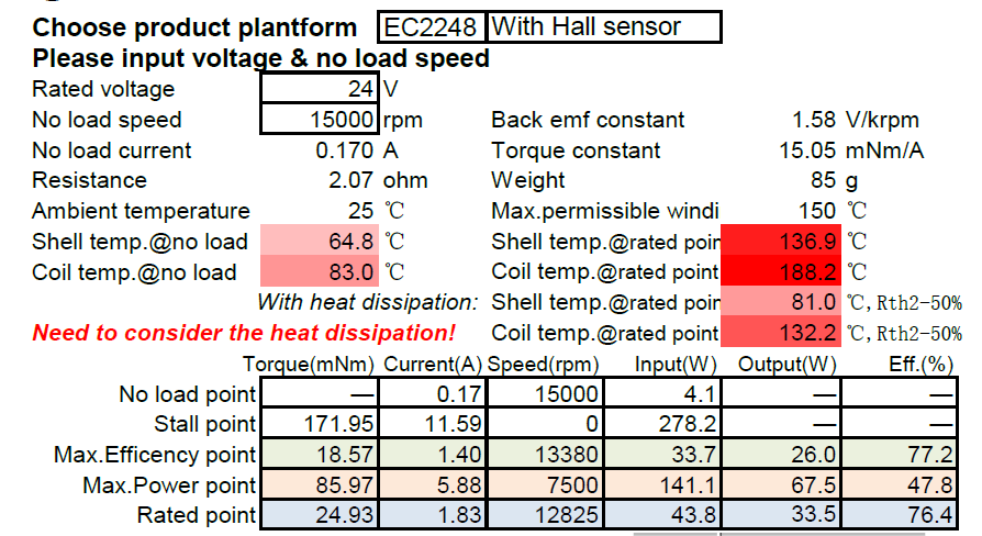

My motor:
0693W00000BdcLTQAZ.pngIn the MCSDK I set value:
0693W00000BdcLiQAJ.png0693W00000BdcMCQAZ.png0693W00000BdcM7QAJ.png0693W00000BdcLxQAJ.pngHope you can help,

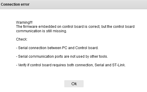

"And I have another question, I can connect MCSDK ,but I try connect Motor Profiler warning.
It say control board communication is still missing. Do it effect my control speed accuracy?"
Sorry I do not understand what did you try to achieve. The usage of UART is exclusive, so you can not connect both in the same time MCSDK and profiler tool if it is what you tried to do.

1. The motor profiler doesn't successfully.
When I click connect in motor profiler , it finally show this error.
0693W00000CzlTAQAZ.png​2. Yes, I click "start motor" or "Encoder Align" the motor run in a moment, and the Status Over current Light up.
I have check I don't connect both in the same time.

Hello @KChie.1​
Before going forward, you should check what is wrong with the Profiler connection.
Profiler requires the STLink connection in order to flash a dedicated firmware, and also the UART to send command to the board.
Are you sure that the boards you selected in the motor profiler tool are exactly the one you are using ?

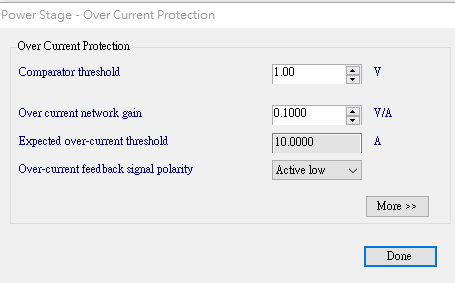

The warning displayed by MotorControl Workbench is due to over current with my settings, but the Max current provided by my power supply is only 6A. And I setting my overcurrent protection 10A.
Is this because of inaccurate detection? Or is my control board broken?
