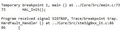

Thank you for all your answers. After long time I turned back to this project again. I had same problem with totally new design and pcb. Then I started to use CubeIde instead of Keil. I saw its going to HardFault_Handler every time, Keil cant catch it most of the time. In debug console I saw this:0693W000008xOVJQA2.jpgthen we searched for SIGTRAP. In https://github.com/stm32duino/Arduino_Core_STM32/issues/1206 this link I saw "For the clock issue, it seems your board have an issue with the HSE Bypass (clock provided by the STLink).". My problem was valid all the time not only during debugging process. Also I saw something about HSI in errata. So we decided to change clock configurations. I was using 64 MHz with PLL, I changed it like 16 MHz with HSI. Now I have no problem. Everything is working fine. What I dont understand is this if I use 64 MHz and PLL and run MOTORS its going to hard fault but if I run LEDS or just switch relays without any load its working fine. So drawing high current damages PLL and it makes this error?

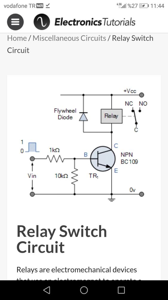

0693W000002lhlCQAQ.jpgOur switch circuit is totally same with the circuit in the picture. Its my bad to ask question on Friday evening, I cant access the circiut or documents until Monday.
If the problem is this, how can we prevent this? Is there any circuitry sample to prevent this? Then we can try that solution.
waclawek.jan
Disconnect the motor. Make the relay switch fast, like 3Hz. Still problems?
If no,it's on the swiching (motor) side. As Peter said, switching inductive loads results in high voltage spikes even arcing. This is a group of problems which don't have a single simple solution, so you have to read and decide yourself; using a suitable snubber network may be a starting point.
