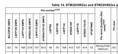

I am evaluating the Nucleo Board H563ZI now.
I notice a very curious pheonmeon. In CubeMX, I didn't configure any SWO or JTAG pins, they are all disabled. However, when I generate the project, I am still able to download the program into MCU by ST LINK on the board ( USB Type-C) and go into debug mode.
Why is that?

its not a curious pheonmeon .
YOU didnt configure SWD - but the chip has a default on power up , setting some pins to a default mode.
So SWD enabled at start...
see ds, pin default settings !
like this:  (note...function after reset ! )

Thank you for your response, it solved my confusion. I really appreciate it.
