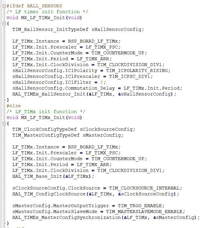

  1. As you can see the below picture, in the hall sensor case, there is no initialization for master/slave in commutation event (main.c). Is this code right or not? I think this code is not true.

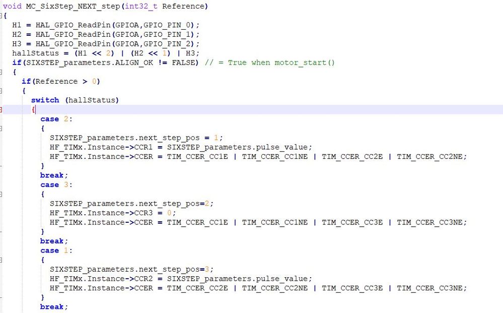

2 . May you explain to me why MC_TIMx_SixStep_timebase() function is called 2 times, first is in HAL_TIM_PeriodElapsedCallback(), and second is in HAL_TIM_IC_CaptureCallback()? I think it will be called 1 time in HAL_TIM_IC_CaptureCallback() as enough.

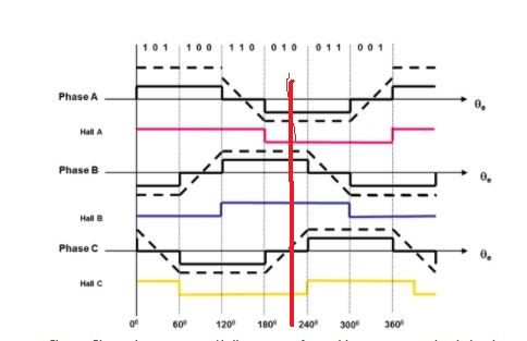

3 . For example, when Input capture happens HAL_TIM_IC_CaptureCallback() is called , assume that hall status = 2, it means as case 2 in MC_SixStep_NEXT_step(), next_step_pos = 1, this function sets up the CCR1 = pulse_value. As the below picture, I think we should set up the CCR2 = pulse_value, is that correct? For my understanding, after the commutation delay, HAL_TIM_OC_DelayElapsedCallback() is then called. At that time, next_step_pos = 2. And then MC_SixStep_TABLE(2) is called, in case 2 in MC_SixStep_TABLE(2) set up CH1, and CH3. It made me so confused. May you explain to me? Thank you so much.

  1. Master/slave between the two timers is "hidden" into the "HAL_TIMEx_HallSensor_Init(&LF_TIMx, &sHallSensorConfig)" function
  2. MC_TIMx_SixStep_timebase() is the function that changes the step. Due to the general purpose of the firmware, it is called in the HAL_TIM_IC_CaptureCallback() when using the hall sensors and in the HAL_TIM_PeriodElapsedCallback() when the sensorless mode is selected. The HAL_TIM_PeriodElapsedCallback() is not triggered in the hall sensor mode.
  3. In Hall sensor mode the pulse value is configured during the HAL_TIM_IC_CaptureCallback (). The HAL_TIM_OC_DelayElapsedCallback () operates during startup phase only in case of unexpected timout of the Hall sensor timer. In fact the very first conditioning here checks the Hall_ok status condition.

In order to set or reset OCxM, some document use the TIM_SelectOCxM command. but in MC_SixStep_NEXT_step() function, there is no TIM_SelectOCxM to control OCxM as the below picture. May you explain for me? 0693W000006EQRyQAO.jpgThank you so much

Hi @Vnguy.1​
The TIM_SelectOCxM function comes from the old standard libraries for STM32. The new HAL doesn't provide this specific function.
In any case the objective here is managing the channels of HF timer in order to set the high-impedance state in one of the phases.
The code achieve this result through the writing of the CCER register and enabling/disabling the channels.
