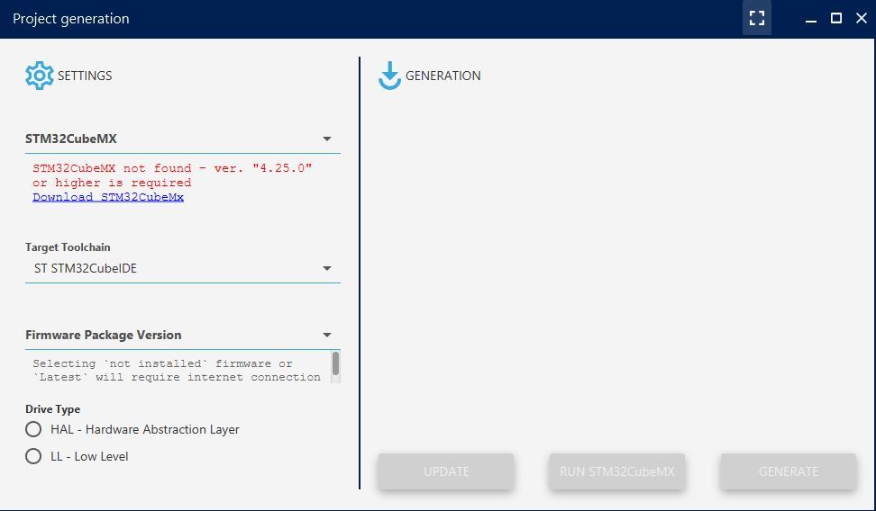

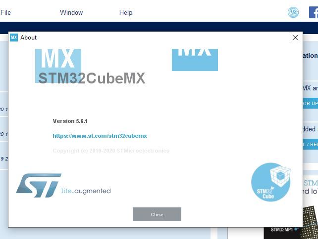

I would like to use ST Motor Control Workbench for BLDC FOC Control. I have installed version 5.4.4 and used an example project to generate code. However, the workbench doesnt generate code and gives error ("STM32CubeMX not found - ver. "4.25.0" or higher is required"). I had already STMCubeMx version 5.6.1 before installing motor control workbench and I am able to generate code using CubeMx alone. Is there a way to link these two programs manually?

Hello @MKara.14 , Try to install STM32CubeMX into the directory "Program Files" instead of "Program Files (x86).

I had the same issue and solved by re-installing CubeMX for all users instead of just myself. Not sure if that was the issue but after uninstall and reinstall 3 times I tried this and it worked out.

Then, after a little research I found out that my STM32CUBEMX version has been recently realeased and thus was not supported by STM WORKBENCH.
Hence, I downloaded a prior version of STM32CUBEMX (I downloaded the 6.2.0) and everything worked perfectly with no issues.

This problem exists after years and changing windows language to english and reinstalling cubemx solves the issue.
During the installation of stm32cubemx under windows, if language is turkish, it does not show "make shortcuts" page on installation settings and probably missing registry entries causing this problem.
I found out this problem during installing and answer related to changing OS language gives a solution.
It is possibly due the nature of java and local language settings rather than STM32 software. I noticed mostly Turks commented on this problem.
