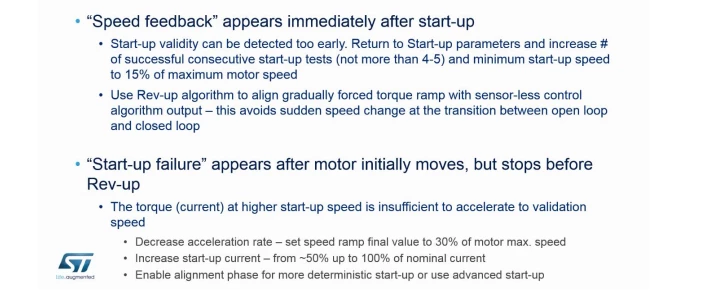

I prepared motor profile for ME1306 with help of EVSPIN32G4 and used in configuration,described above.
But now I get Startup failure on every start. The shaft does not rotate but trembles only.
Can I get any advice how to debug the issue?
Appreciate in advance.

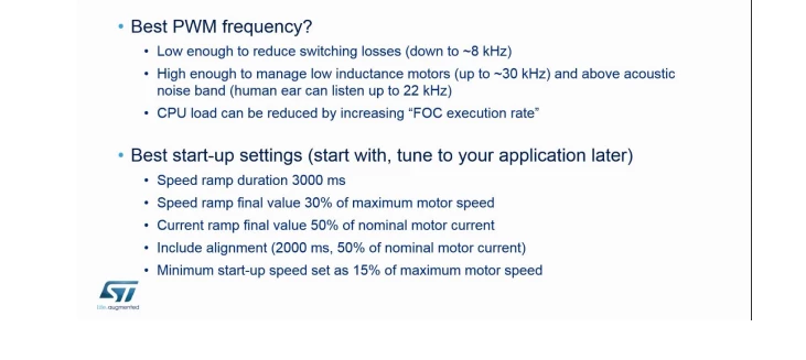

    Hey @tasifacij
    Here are some screenshots that might help you get a better startup procedure.
    please note that speed feedback, startup failure, and over current errors may  arise due to hardware issues.

    And I can rotate the motor if open loop is enabled.

    My issue was caused by invalid ICS wiring. I read an inversed signal and PI controllers became crazy of that.
