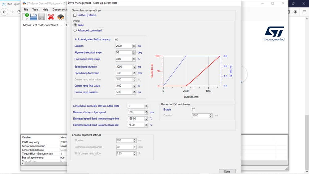

I set the motor control parameters as follows in MC workbench
  • Alignment before ramp up: 2000 ms, final current 3A, electrical angle 90 deg.
  • Speed ramp duration 3000 ms, final value 100 RPM
  • Current final value is 3A.

  1. This is a screen shot of the start up settings I am using in MC workbench:

First of all I noticed an issue in your startup parameters. Indeed your minimum start-up output speed is equal to your final speed ramp value (100 rpm), with this settings you can get a STARTUP_FAILURE error .Indeed one of the conditions to close the loop is that your observer measures a speed greater than your "minimum start-up output speed" (i.e. 100RPM). So when you will reach 100rpm the revup controller will detect that it is the end of the startup phase and as the observer has not measured a speed greater than 100rpm it will raise a fault. Then I suggest to decrease your "minimum start-up output speed" to maybe 80 or 90 RPM.
The other issue is that the motor does not spin during startup phase which is necessary to make the observer converge. So if your motor only wobbles that's not good. Could you please try to decrease the current of your startup phase. You can do it by opening "configuration" panel in the monitor and maybe divide by 2 the "final torque" value. Here the current is expressed in S16A unit which is equal to (current_in_ampere*65536*shunt*Amplification_gain)/uC_VDD.
In this panel you have access to the five stages of the startup phase so can try tune them and check that you are able to make the motor spin.
