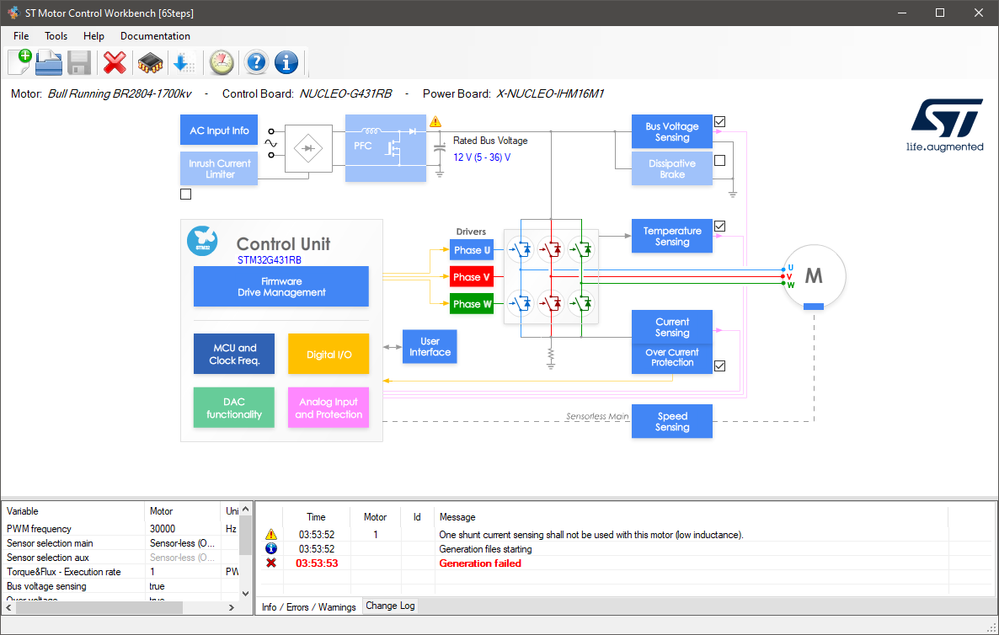

ST Motor Control Workbench Code Generation Failed
SLi.9
0693W000006GYAGQA4.pngI cannot find a way to get this to work... Already using run as administrator.

I have same problem on below environment.
I think this problem occurs when not use Oracle Java.
  • Environment​
    • common
      • Windows 10 Pro (1909) 64bit
      • MCSDK 5.4.4
      • STM32 CubeMX 6.0
    • problem occur
      • ​Adopt OpenJDK 8(x64)
      • Amazon Corretto 8(x64)
    • problem not-occur
      • Oracle Java 8(x64)
