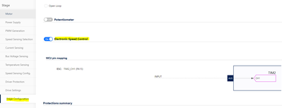

So, After many hours of suffering and understanding the basics of CubeIDE I got stuck and cant find any solution.
My main goal was to control bldc motor by RC controller and this is what i have achieved so far :
void HAL_TIM_IC_CaptureCallback(TIM_HandleTypeDef* htim)
if (htim->Instance == TIM2)
if (htim->Channel == HAL_TIM_ACTIVE_CHANNEL_1)
capture_value = HAL_TIM_ReadCapturedValue(htim, TIM_CHANNEL_1);
if (capture_value)
frequency = SystemCoreClock / capture_value;
duty_cycle = 10000 * HAL_TIM_ReadCapturedValue(htim, TIM_CHANNEL_2) / capture_value;
The thought was to control the motors by the value of capture_value
then I tried to controll the motors by simple potenciometer which also worked really well. Then just withdrawing the potenciometer and implementing the first code.
uint16_t ADC_Data=0;
int ADC_Converted = 0;
long map(long x, long in_min, long in_max, long out_min, long out_max)
return (x - in_min)*(out_max - out_min + 1) / (in_max - in_min + 1 )+ out_min;
void HAL_ADC_ConvCpltCallback(ADC_HandleTypeDef *hadc)
ADC_Converted = map(ADC_Data, 0, 2000, 50, 150);
TIM1->CCR1 = ADC_Converted;
I originally thought that I kinda just put those two codes together(of course with some modifications) but i think Im doing something really wrong. It feels like Im really close but missing something really important.
Please help me, I dont really know what else to do

Hello @Matyáš ,
This forum section is dedicated to the Motor control SDK downloadable here.
Reading your post, I understand you implemented your own motor control algorithm.
In our MCSDK, if you use the inverter B-G431B-ESC1, you can activate the PWM input control:
Doing so, the generated project will contain an esc.c file implementing this feature.
The generated IOC will allow you to understand the timer configuration we used.
Best regards
