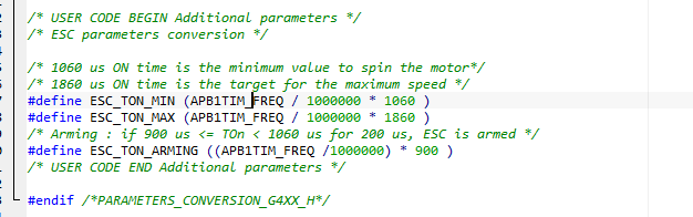

Hi Zied,
I hope you are well!
I have mostly got things working, but I need to now try and use the ESC with a different PWM input, from an RC Controller. The Datasheet only mentions the specific timings you mentioned above- 800us, 1060us and 1860us, is there a way of changing this, as well as the expected PWM rate, from the 490Hz rate mentioned?
From what I know, the software allows the internal PWM generation to be changed, but I haven't seen a setting to alter what external PWM input it expects. Once this is sorted, the system should all be done!
Many thanks,
WB
You will find these values in the "parameters_conversion_g4xx.h" file, as you can see in the image. Do not hesitate to confirm with me if everything is working correctly.
If you agree with my answer, please accept it by clicking on "Accept as solution".
