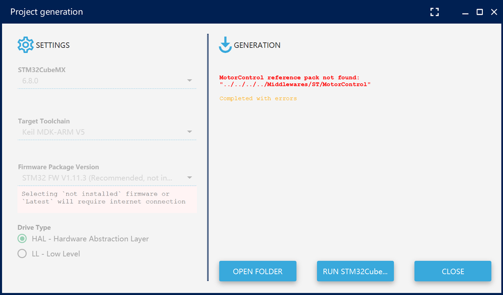

MC Workbench cannot generate STM32CubeMX project
STM32CubeMX.Version: 6.8.0-RC4
MC Workbench.Version:5.4.80693W00000aJqRkQAK.png
Best answer by Curve Wrecker
Thank you so much! It works.
21 replies
March 28, 2023
According to the release note of the MCSDK version 5.4.8 it seems that we can use at most the STM32CubeMX v6.4.0 version, can you try with this version and tell me if it works?
Thanks
"If you agree with my answer, please accept it by clicking on ""Accept as solution""."
Curve Wrecker
Curve WreckerAuthorBest answer
March 29, 2023

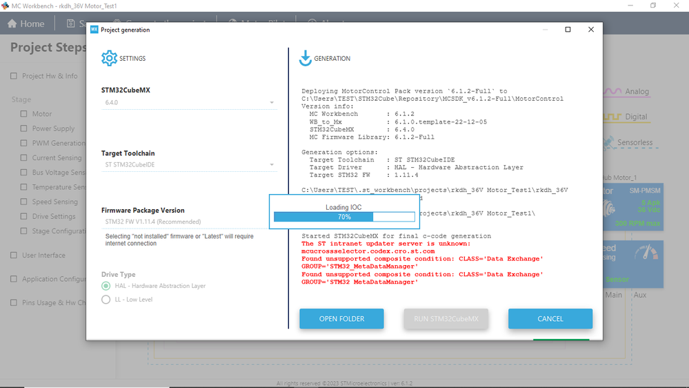

Hi @Zied b.​ ,
I too have a similar problem but with mCSDK version 6.1.2 and tried using STcube MX 6.4.0, all the include and source files are generated but showing an error "completed with errors".
can you suggest what need to be done?
thank you
Vijay
VGani.1
June 6, 2023
June 6, 2023
Hello, according to your screenshot it seems that you are not using the correct version of the MCSDK, it is not version 6.1.2, can you try again with the correct version?

Hi Zied b.
Tried with MCSDK 6.1.2 and 5.4.8 but every version is having same issues. Not able to generate the project successfuly.
Please do check and help us in resolving the issue.

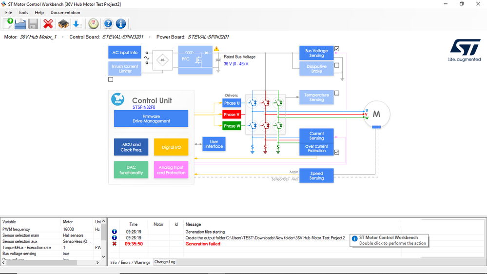

hi Zied,
Tried using latest version of Workbench, CubeMx and IDE. But still the same issue. Couldn't understand the error existence. Please help us to resolve the issue. Do we miss any drivers or softwares??
Thanks
Vijay

June 6, 2023
If we wait for longer time, all source files and include files are generating but if we press close button, it shows generation is failed.
CubeMx Installation Path: C:/Program Files/STMicroelectronics/STM32CUbe/STM32CubeMX
MCSDK Installation Path: C:/Program Files(x86)/STMicroelectronics/MC_SDk_6.1.2
June 6, 2023
thank you for answer, the generated project should be the one you need, despite the error. We'll be working on a solution to this error.
