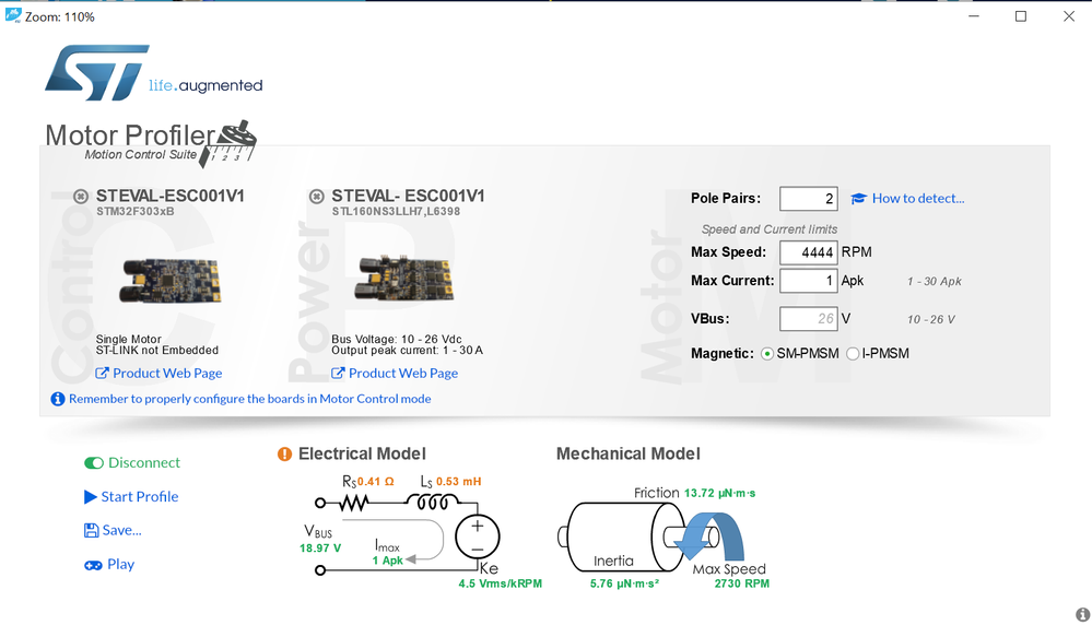

Hello, i am using the STEVAL -ESC001V1 evaluation board .
i am using the Motor Workbench 5.4.8 with motor profiler .
the motor profiler can connect to the evaluation board but when i click profile ,it shows profile failed .
can anyone tell me how to resolve this issue?
1 REPLY 1
Zied b.
Dear Customer,
I tested your configuration and it works correctly as you can see on the picture0693W00000WKMg2QAH.pngCan you tell me what device you used to connect your ESC001V1 ?
I used an ST-Link V3 to connect the st-link and Uart part of the board.
You have all the information on the UM2197 chapter 3.
