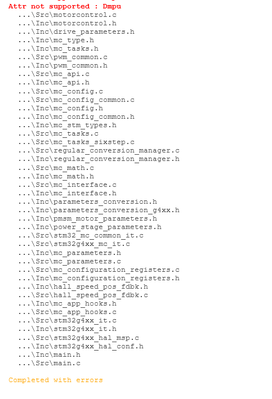

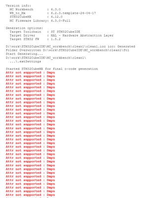

now i am trying to use MC workbench 6.3.0 to generate a simple design, but there are errors.
the log is like below:
what is worry with MC workbench? please help.

I have checked the post you mentioned, it seems the issue is still open, errors still occur.
but you said the project is fully generated, i can use it. so you mean the errors can be ignored , just use the codes, right?

Hello @dqsh06,
Yes, issue is under investigation. Please ignore it for the moment and use generated project.
Best regards.
