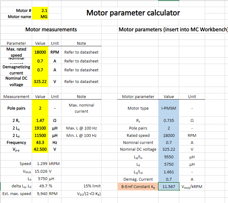

I'm using EVSPIN32F0601S3 to run a BLDC motor. The max RPM of the motor is 18,000. Whereas I could go up to a maximum of only 15,000 RPM.

If i were you i would post more info about your motor

Thanks for the info, attached the motor specs.

How much current are you measuring when reaching 15000rpm?

Less than 1.2A in the motor phase when measured in AC Fluke clamp meter.
I have tuned the current regulator PI values by using the step function in the monitor.
And after a few minutes of continuous running(no parameter changed), the motor stalls and gives a speed feedback error in the monitor.
