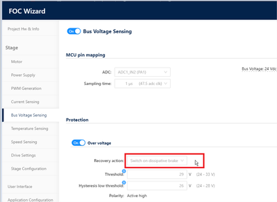

how to lock the bldc motor with brake applied?
Sudhakar.R

Dear Sudhakar.R,
Firstly, we would like to sincerely apologize for the delay in replying to your post.
If your point is still pertinent, if your question is to how set "Switch on dissipative brake" option, it is located on "Bus Voltage Sensing">"Over Voltage"
