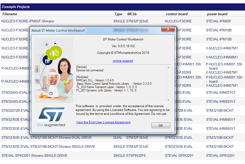

I'm attempting to generate project code for the STEVAL-SPIN3202.
ST32CubeMX doesn't have an option for the
STEVAL-SPIN3202 so I tried using the ST Motor Control Workbench and it gives an error 'STSPIN mcu not supported in the FW for SDK5'.
Meanwhile, I'm using the example project provided in 'STSW-SPIN3202'.
Is there an add-on for ST32CubeMX to generate code for the
STEVAL-SPIN3202?
Should the ST Motor Control Workbench generate code for the
STEVAL-SPIN3202?
Is the STEVAL-SPIN3202 and older product and maybe I'd find better support for a newer variant?

look at the last line
‎2018-04-14 12:39 PM
Vitaliy-
Good point but I still got the
error '
STSPIN mcu not supported in the FW for SDK5'. I'll try opening that SPIN3201 project and try it with the SPIN3202. I'll post a question asking what the difference is between a 3201 and 3202.
BTW, your post with the PDF - were you trying to say RTFM? I'm not sure what your point was. I already had, and read, that PDF but it didn't really help with the STMCWB. I wasn't sure if you were suggesting that I skip the software tools and just write code from scratch - which certainly is another valid way of approaching the problem.
-Jim

Dear Jim,
STEVAL-SPIN3202,
STEVAL-SPIN3201 will be back in the 5.1 release scheduled for end of May.
As the SPIN32F0 is based on a STM32F03 MCU, you can already generate the code with the 5.0.3 release but it is not so straightforward.
Regrads
Cedric
