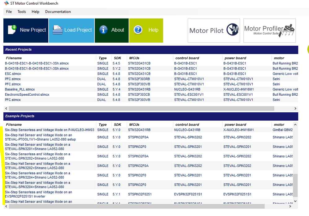

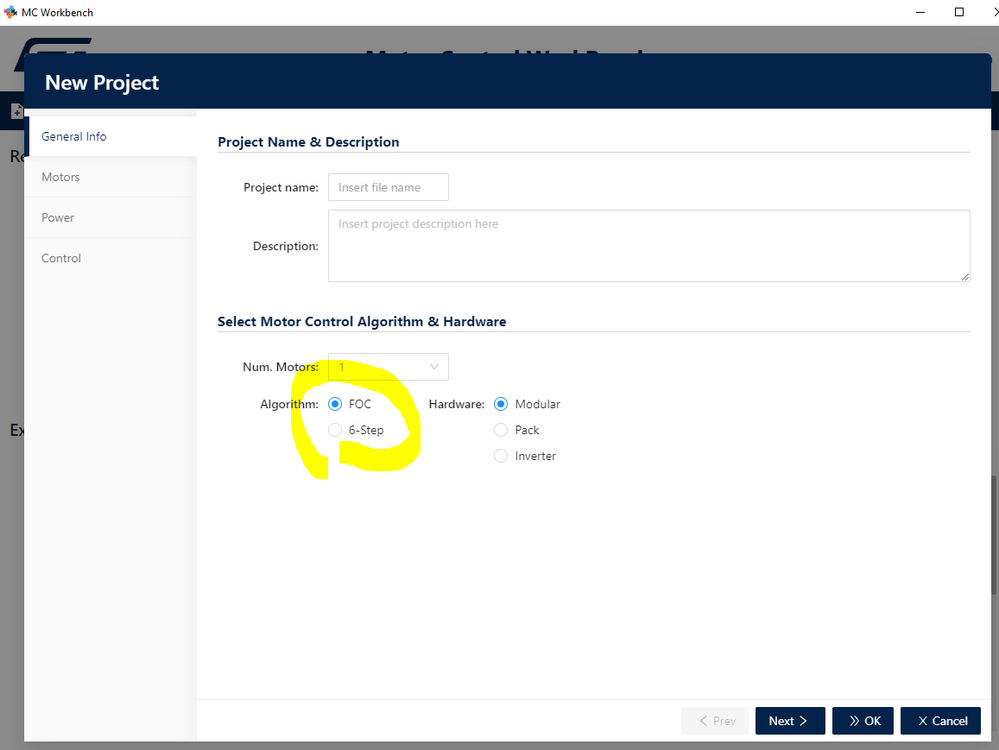

This might be the most banal question you've heard all day. I don't know if it's even possible, but I thought there is the option of switching between the two. I'm using hall sensors for my application, so it probably doesn't matter much either way.
Would any kind soul help me out? Any advice is appreciated (especially screenshots of where to find stuff within the latest MotorControl Workbench V5)
I'm using a B-G431B-ESC1, by the way.

Hello Popeye
MCSDK's latest version 6.1 allows usage of both 6 Step and FOC algorithms. The selection can be done during project creation, as can be seen below :
0693W00000Y9ixLQAR.pngConcerning 5.Y and older versions of MCSDK, 6 Step algorithm is only available via examples that can be found on home page of the Workbench.
0693W00000Y9iysQAB.pngHoping this will be of any help.
