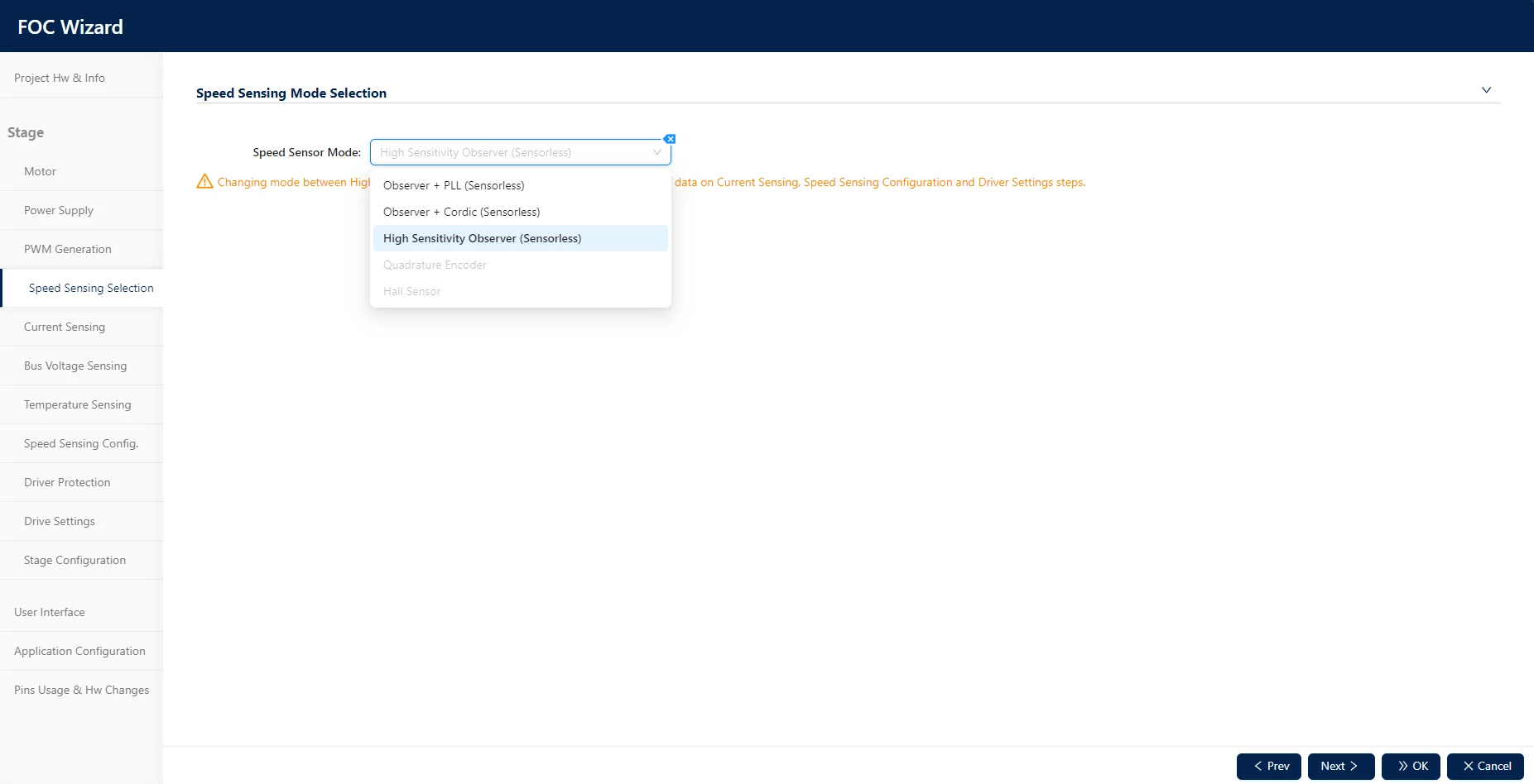

I have purchased STM32 ZeST evaluation kits, includes
B-G473E-ZEST1S
STEVAL-LVLP01
B-MOTOR-PMSMA1
I would like the evaluate the ZeST performance, however, I don't know how to activate it.
In Motor Control Workbench 6.3.0, I CAN NOT found the option of ZeST in "speed sensing selection".
(such as following figure)
Can you guide me how to activate ZeST and furtherly to evaluate it?
    2 replies
    Gael A
    July 12, 2024
    Hello yang2,
    The STM32 ZeST algorithm is currently available for selected customers only ; as mentioned here. Only the HSO is available via MCSDK for the moment. If you really want to develop an STM32 ZeST application, then you would need to contact your closest ST sales office.
