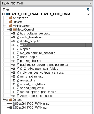

I am currently working on a project considering the B G431B ESC1 and a BLDC motor.
My goal is to control the motor through a external PWM Signal from a nucleo board.

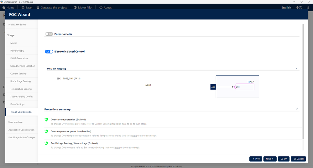

So far I could only control the BLDC motor through the MC Profiler and only in 6Step mode.
After some research I found out that in order to control the BLDC motor with an external signal the ESC setting must be activated in the "Stage Configuration".
I did that and generated the code for the B G431B ESC1, however I recieve the following error message found in error.txt.
Some variable seems not be declared.
Any tips on how to solve this issue?
Thanks in advance
Batu

The ESC with PWM input support has been initially developed for the FOC solution, and we missed to check it with the 6-steps algo. We will correct this issue in the next patch release MCSDK 6.3.1.

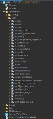

I actually tried the FOC algo aswell. At least here the code that got generated could be build successfully.
After deploying the code to the ESC, I connected the ESC to a power supply and I am trying to control the motor via a PWM signal from a nucleo board.
I wrote some code that changed the duty cycle of the PWM signal from unarmed to armed. I hear a beep noise (I assume its the sound that tells that the motor is ready) but there is no movement on the motor.
Here is the relevant code, that I run on the Nucleo board: I measured the PWM Signal with a logical analyzer and confirmed the period/dutyCycles.
