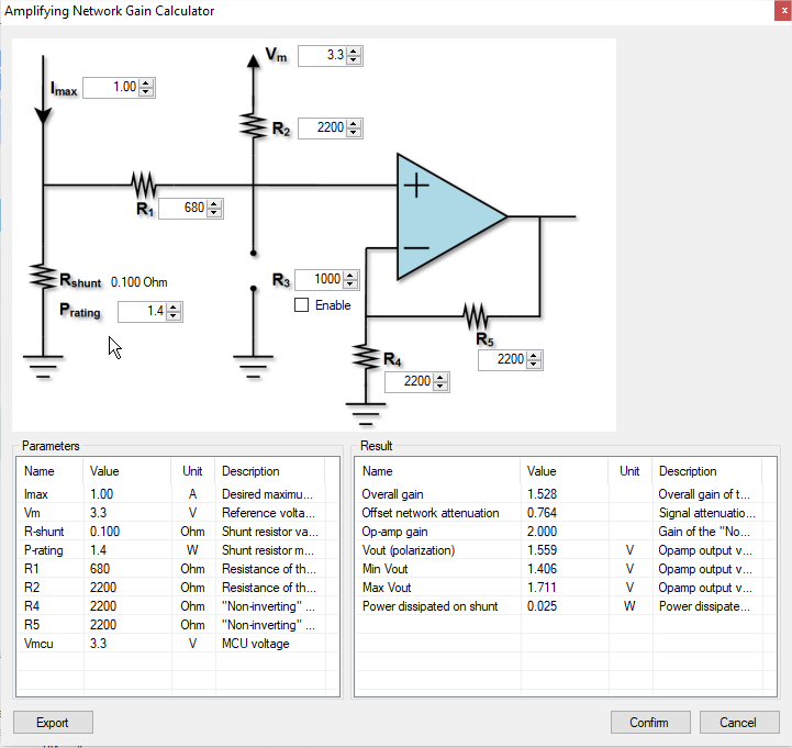

I suspect the noise is just because the current sense resistor value of 0.1 ohm. Plus the amplifier gain of just 1.53, is giving a full range current measurement capability of >10A. The power board and STSPIN233 device is only capable of 1.3A, and with the motor I am using, the max current is about 0.5A, though typically running at 0.1A. So we're only using a small range of the ADC. So I suspect the noise is just ADC noise and a small signal to noise ratio.
Do my values of 1.53 amplifier gain and 10A measurement range seem correct for that board?

If you open a ST Motor Control workbench and go to "current sensing" box, set "Shunt resistor value" and click on "Calculate". Modifying current or Rshunt value, it computes directly the output dynamic (Min Vout / Max Vout). If you can change physically the Rshunt, you can verify the resulting dynamic.

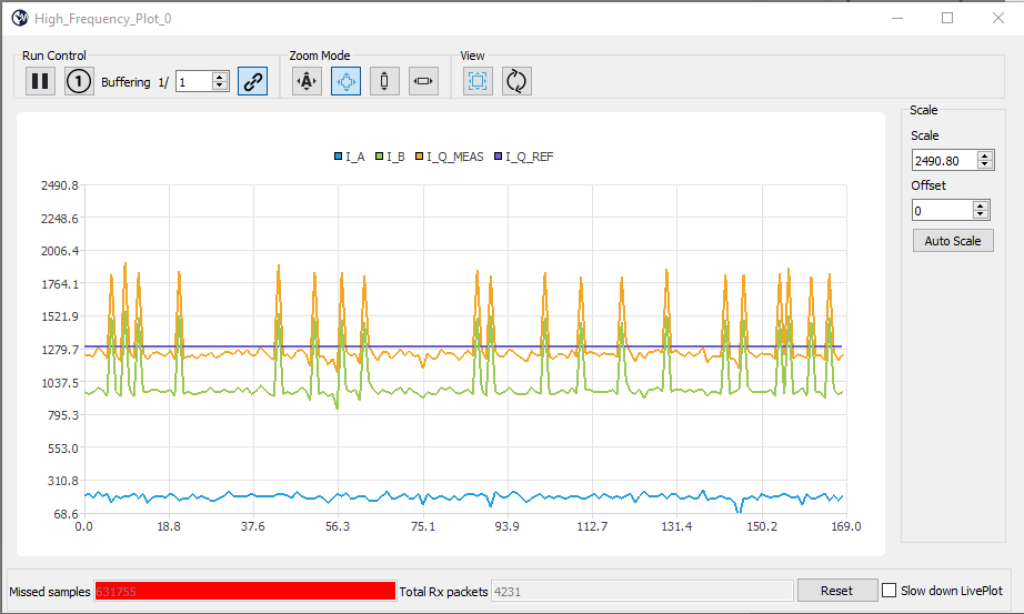

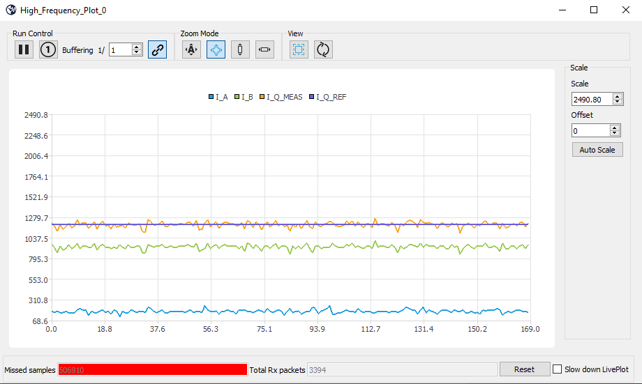

Doing some more digging I think something else is going on with the current. I currently have the motor fixed so it does not rotate. If I run it in torque control mode and slowly ramp up the torque demand you can see the measure current increasing as you expect. It has some noise on it but not too bad (1st image). However, once you reach a certain point it get huge amounts of noise on it, as in the second image.0693W00000Ka8vRQAR.png0693W00000Ka8vbQAB.pngthe I_A current is just about straight off the ADC I think. However this looks like a measurement error rather than what is really going on in the hardware. Any ideas what this could be?

Just a further note, I am running this in 3 shunt mode. This issue seems to relate to current sampling when as the PWM pulse on time becomes very long as measured on the IN1,2 3 inputs on the power board. I'm guessing the current is measured in the off time and something is going wrong as this period becomes very narrow. Again I'm not sure what influence tRise is having here as all the references to it in the documentation are related to the single shunt operation.

Thanks. I have studied that section very closely yesterday. I have tried various settings for T-rise, T-noise, Min Dead time, HW Inserted Deadtime, and sampling time.
My current settings are:
Trise = Tnoise = 150nS.
Min dead time = 200nS
HW inserted deadtime = 300nS
Sampling time 3.0, giving a sampling time of 250ns.
But I have tried many other combinations.
What I have also seen through debugging, is that the function R3_1_SetADCSampPointSectX, choses one of 3 sampling strategies based on the values above and the current PWM edge times. Most of the time it is sampling in the middle of the PWM, and this is the one that works (the first strategy).
When the low duty cycle pwm becomes too narrow for this it switches to the second option, and sets the sample point to to be lowDuty - hTbefore, where hTbefore is 2 * sampling time + conversion time. This is the one that causes the big jump in current measurement. The noise is caused by rapidly switching between strategies 1 & 2.
I'm not sure where the conversion time is set, or quite where in the PWM cycle this second strategy is trying to set the sample point. Seems to be in the bit between the low & mid duty cycle pwm.
