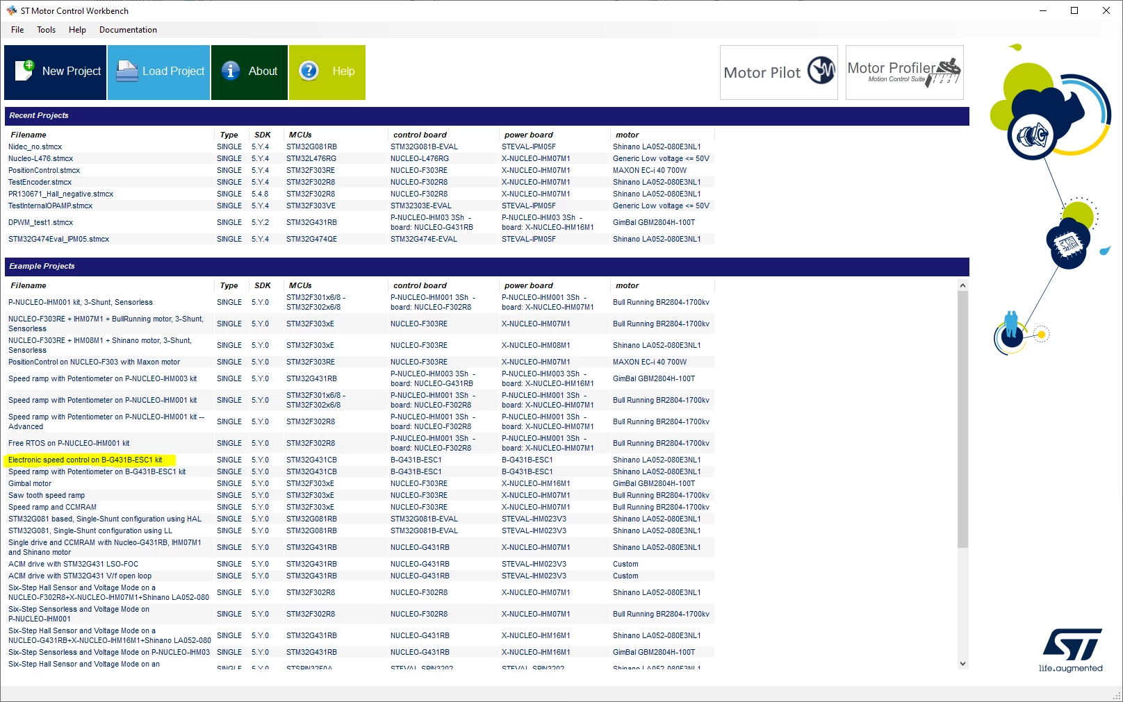

Hi All,
Background: during my very first experiments with the STM32 Motor Control SDK 5.Y.2 I did hear something like a two tone alarm coming from the motor when a critical overcurrent or overload situation occured. I was pretty sure at that time, there there must be some routine that uses the motor as a speaker to emit such a beep when required.
Topic: With my current project it would be quite handy to be able to output a short beep in some situations without having to assemble dedicated speaker or beeper. But I could not find a piece of code in the MCSDK-Lib that is related to such a function.
Question: My question is now, whether the alarm I did hear with the older MCSDK was just an artifact of the motor control. Or was this an intended functionality and got removed during the code cleanup in 5.Y.4?
Has anyone used a motor as speaker with the MCSDK already? In my opinion that should be possible since a motor and a speaker are not very different.
Regards
Thomas
Best answer by cedric H
I have in mind MC Workbench 5.Y.4. look at the attached screen shot.
The example is not ported yet on version 6.
Regards
Cedric

cedric H
September 26, 2022
Hi Thomas,
You are right, we have indeed specific code to generate some tones with the motor. To have access to it, select the ESC-G4 board from the example list. (Be aware to select it from the example list and not from the board selector).
The code you are looking for is in esc.c file and there is a dedicated esc_beep_loop function.
Best Regards
Cedric
