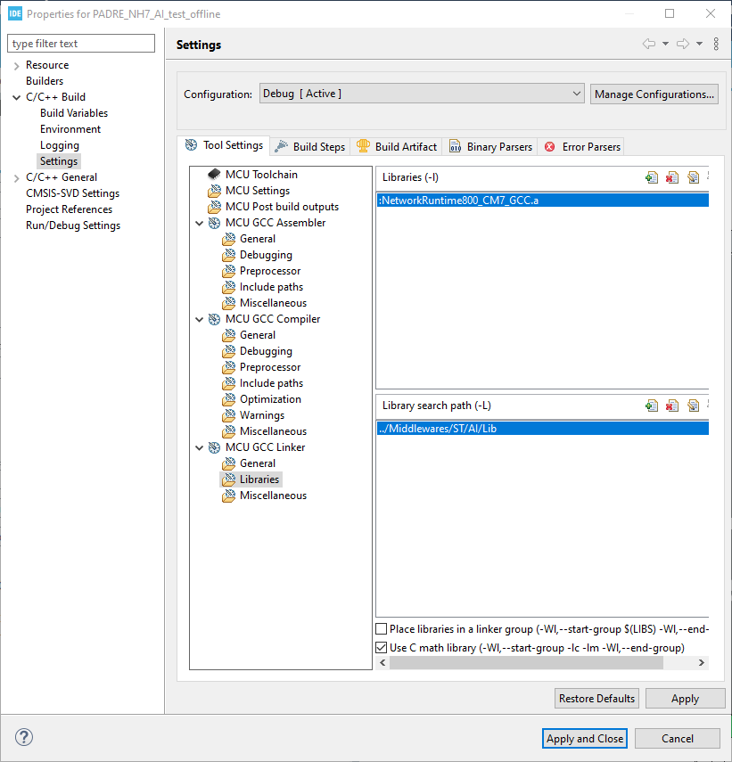

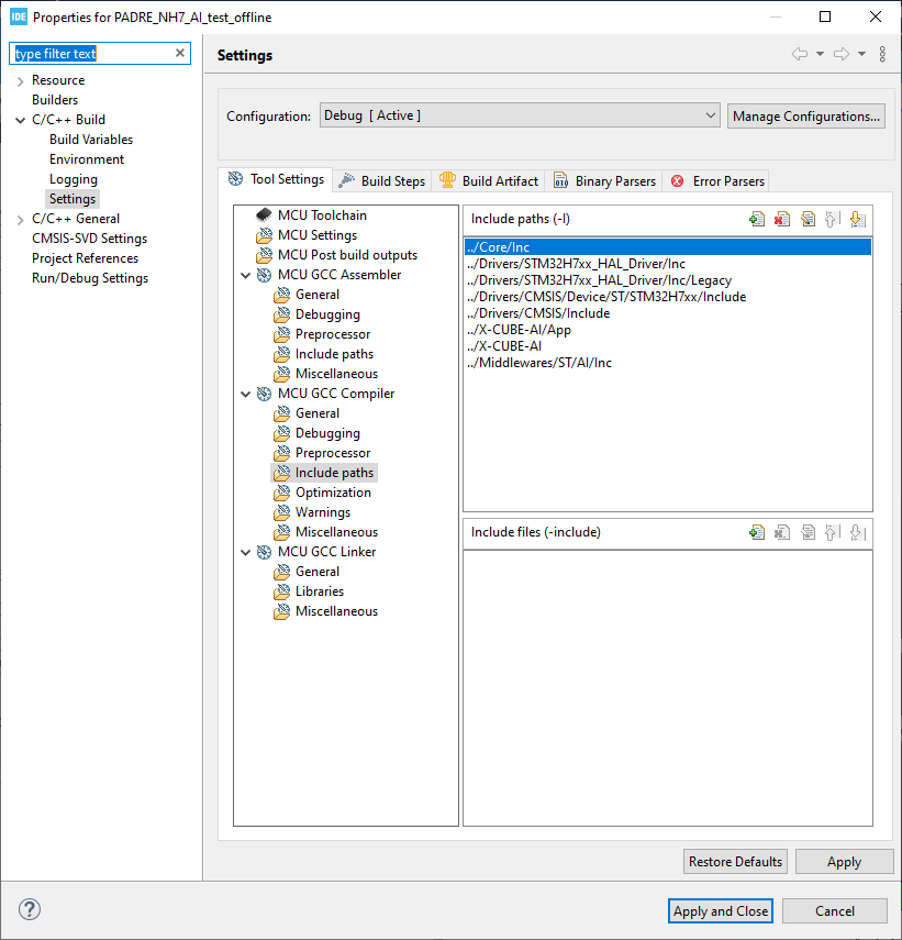

How to deal with fatal error: ai_platform.h: No such file or directory? I can't find this file anywhere in the project.
I tried using different versions of CubeIDE and X-CUBE-AI, added include paths in project properties. I checked on F7 and H7. I have Core and ApplicationTemplate selected in Software Packs Component Selector.
The problem started with the inability to use USART along with the X-CUBE-AI package enabled. Then no error appeared, only communication over USART did not work.
I am currently using CubeIDE 1.12 and X-CUBE-AI 8.0, and have updated what I can.
The last time AI worked for me I was still using Eclipse (SW4STM32), but it no longer supports the latest chips I use.
Please point out what could be the problem.

Middlewares folder is not generated in the project, I do not know why.
After copying this folder from another project, the problem with ai_platform.h disappeared.
On the other hand, I am still unable to use communication via USART. I am trying with USART 2 and USART 3, Nucleo H743 board and H743 chip of LQFP176 version. The result is always the same - USART does not work. The rest of the program seems to work normally.
RPuch.2
April 22, 2023
When I change from SystemPerformance to ApplicationTemplate, the Middlewares folder disappears but the compiler still requires it. Is this some CubeIDE bug?
