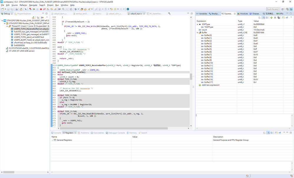

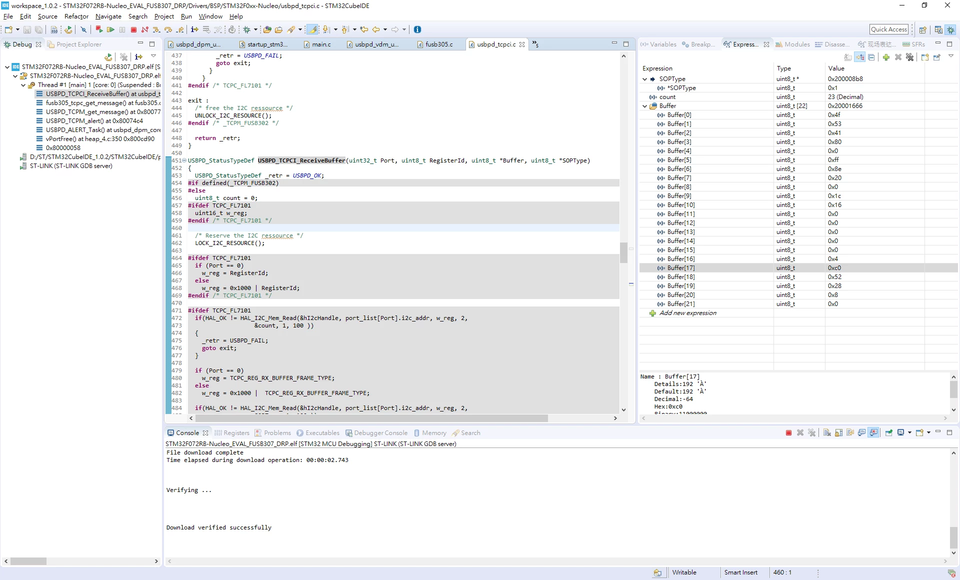

Act as the DFP. I request the PE to send SOP identify request to the UFP after PE received the data it didn't fire the callback function. (I set the breakpoint at fusb305_tcpc_get_message and i see the data received from the DFP is correct.)
But
  1. when i request the PE to send SOP SVID request to the DFP it did fire the callback function.
  2. when i request the PE to send SOP' identify request to the cable it did fire the callback function.
I'm not sure if i set the configuration correct or there is any problem in the usb pd library.

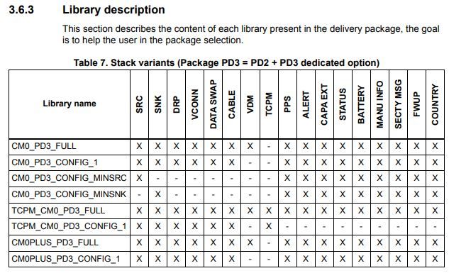

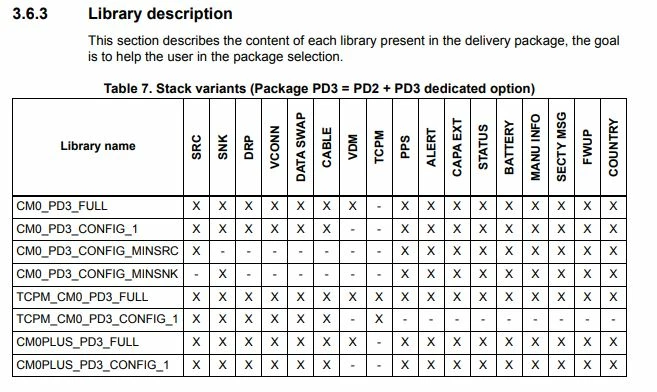

Project 'EVAL_FUSB307_DRP' delivered with 'STM32CubeExpansion_USBPD_F0_V2.1.0' does not have the VDM option enabled.
User Manual UM2552 explains the different libs delivered with FW package:
It means that you have to:
  • select USBPDTCPM_PD3_FULL_CM0_wc32.a in your workspace (instead of USBPDTCPM_PD3_CONFIG_1_CM0_wc32.a)
  • enable swich USBPD_TCPM_LIB_PD3_FULL (instead of USBPD_TCPM_LIB_PD3_CONFIG_1)
(you can refer to Consumer_VDM_RTOS application which enables VDM by default)
To help you, I updated the project to enable VDM and import usbpd_vdm_user files which allows to implement different VDM callbacks.

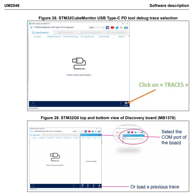

For your information, I also enabled _TRACE in this project to allow to evacuate traces over USART pins (PA0 & PA1) connected in my side to VCP used in ST-Link.
Further details described in another post:
"in the projects we deliver, the internal trace is enabled. It is possible to see if you have communication between 2 boards.
Trace is done through USART pins connected to ST link. You should use Cubemonitor-UCPD and use the functionality described in the following image:
Regards,
Yohann

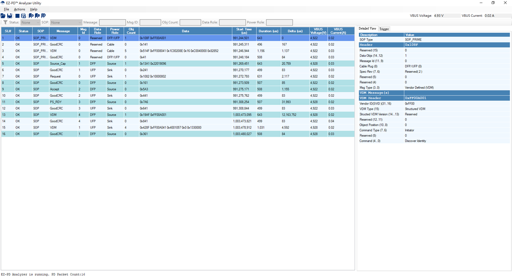

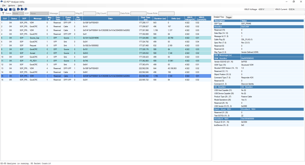

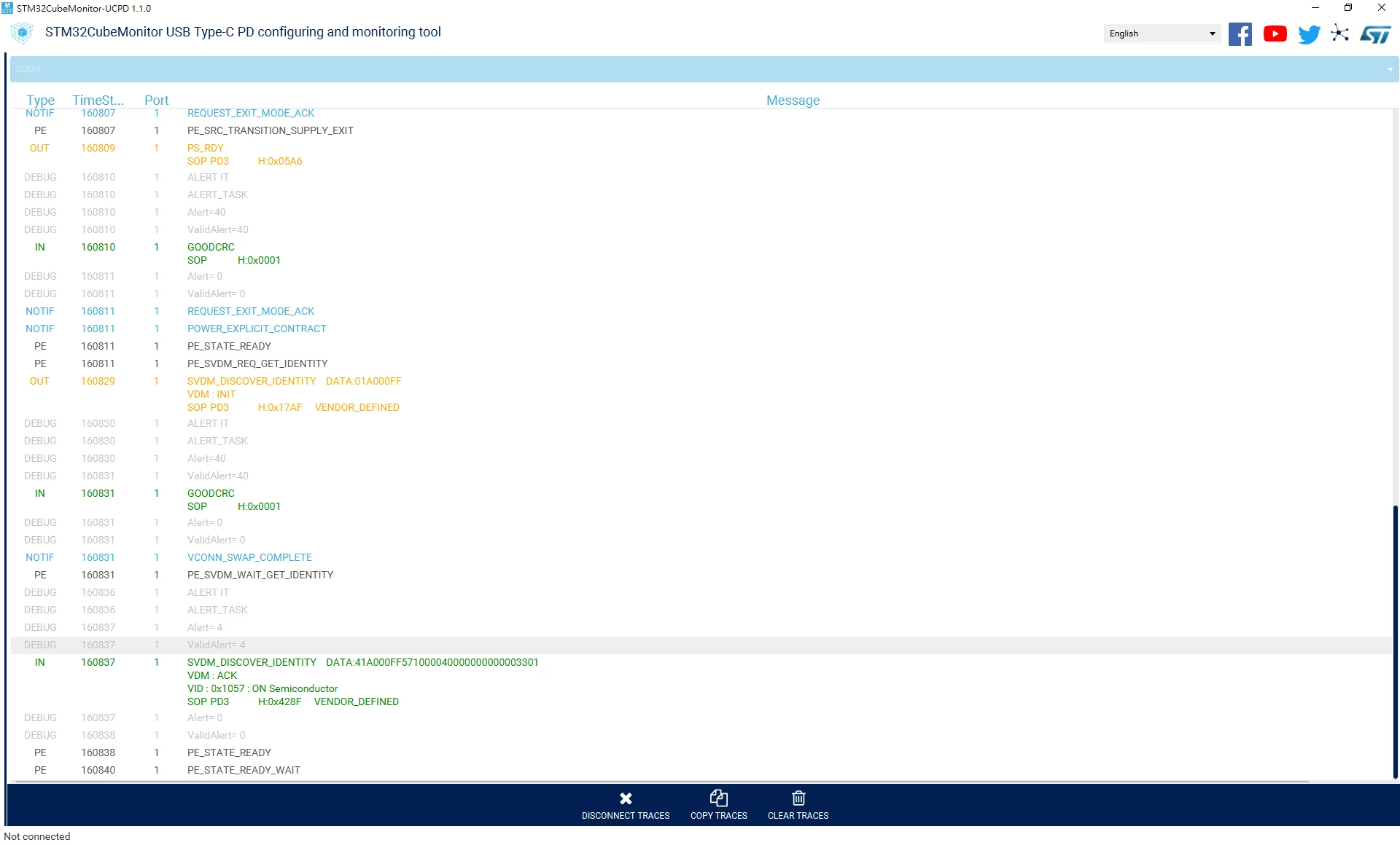

I followed your step but the problem is the same when mcu received the VDM message from the partner port, UPF, it didn't call the callback function USBPD_VDM_InformIdentity.
It is the screenshot of the STM32CudeMonirot USB Type-C PD shows PE actually received the message.
BR

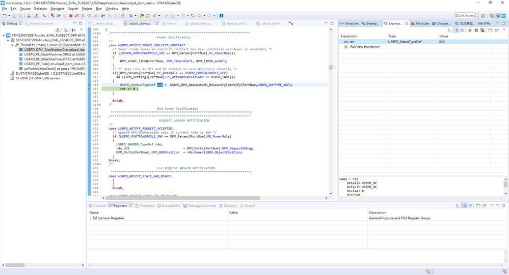

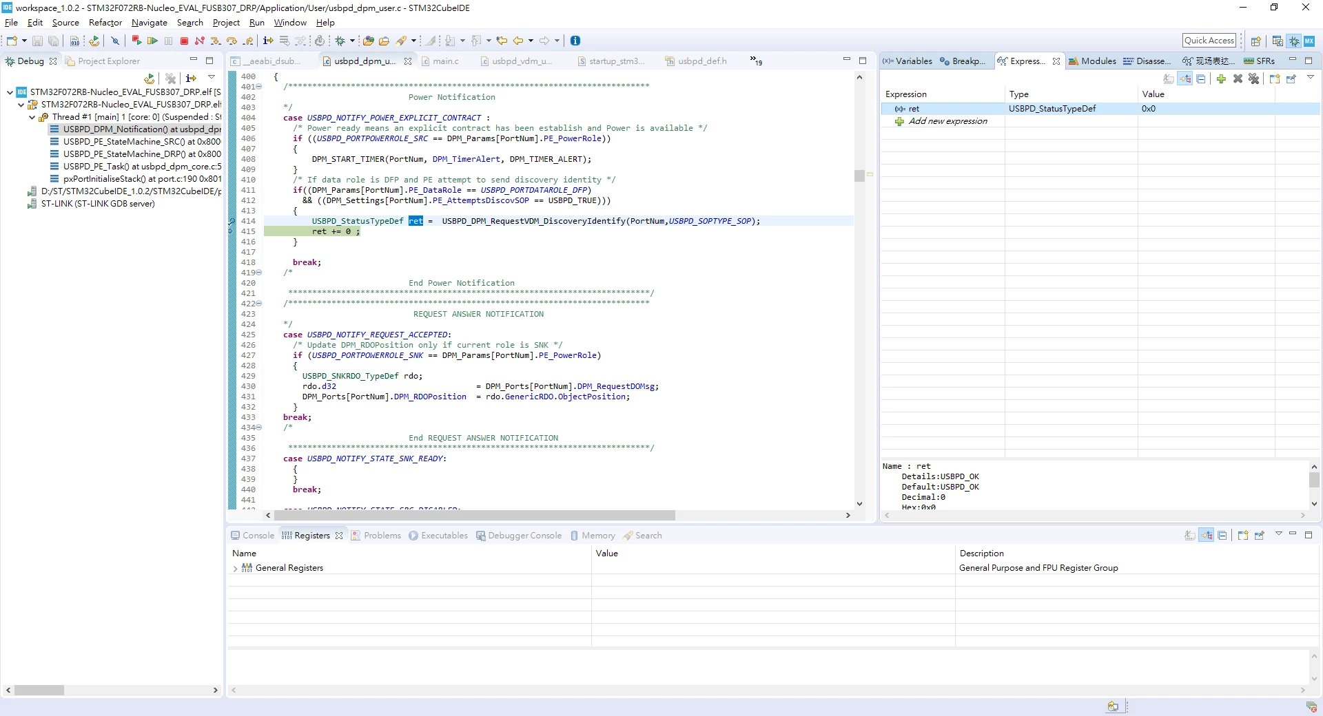

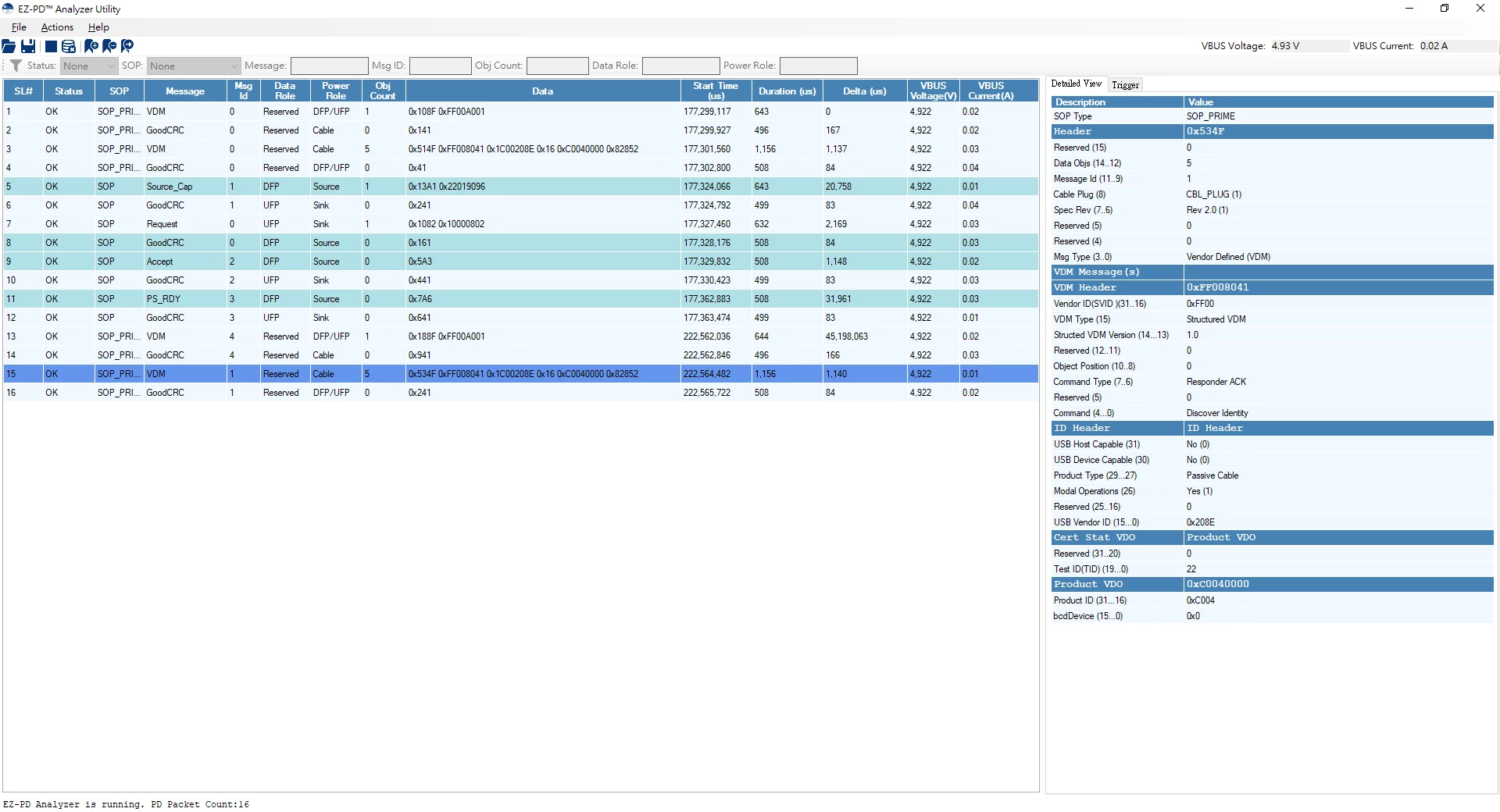

I enable the VDM, VCONN_SUPPORT, USBPD_TCPM_LIB_PD3_FULL and link the library to USBPDTCPM_PD3_FULL_CM0_wc32.
The below is my debug process​.
I use fusb307evb and configure it to
  1. Datarole is UFP
  2. Port type is sink.
1.Sop_1
When i called the USBPD_PE_SVDM_RequestIdentity(PortNum,SOP'), i got the VDM message replied by the e-marker of the cable.
The figures shows VDM message received by usb305 is consistent with what ez_pd, EZ-PD™ Protocol Analyzer for cypress, read then the PE calls the callback function.

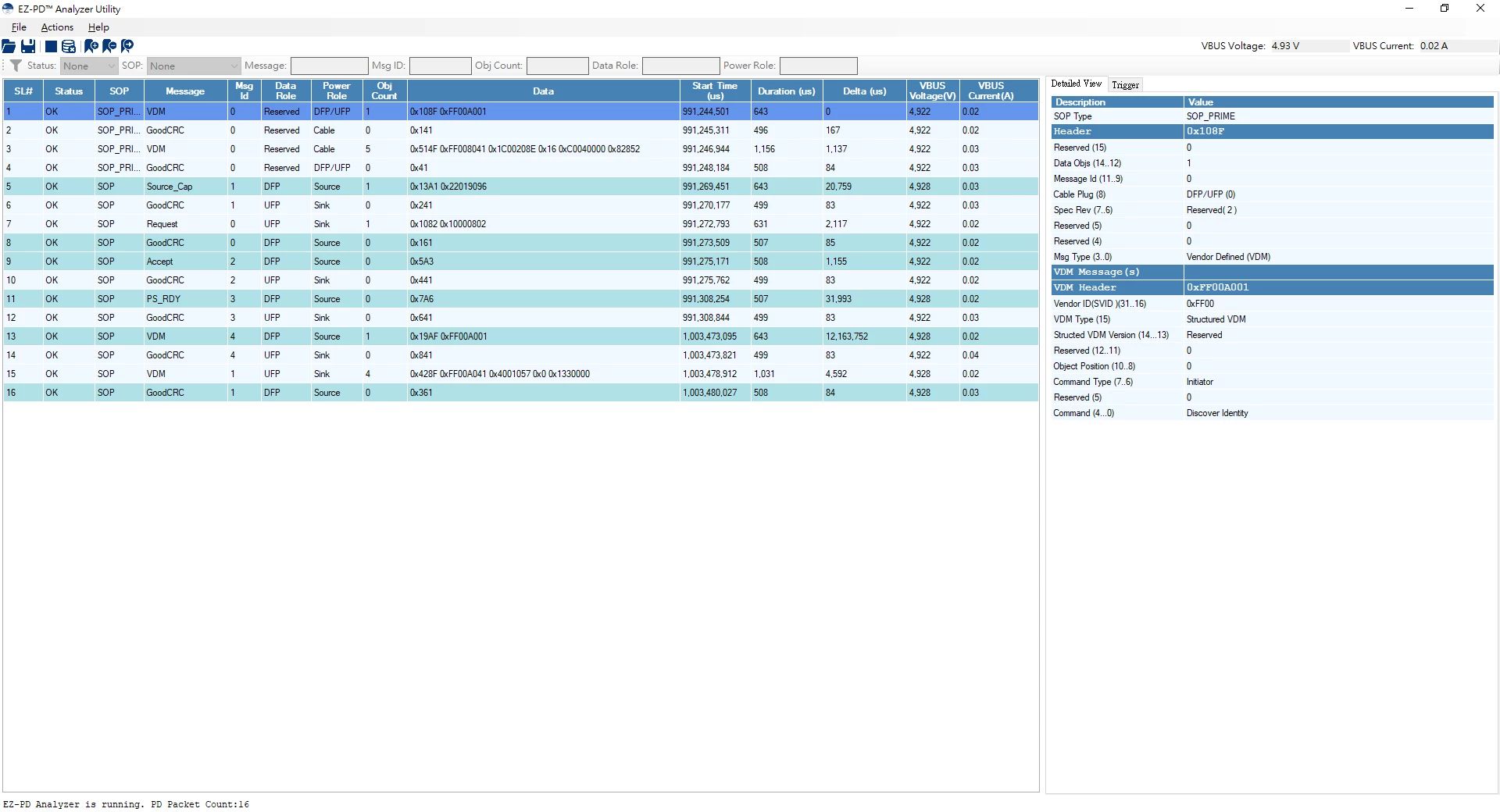

2. SOP
When i called the USBPD_PE_SVDM_RequestIdentity(PortNum,SOP), i got the VDM message replied by the partner port.
The figures shows the VDM message usb305 received is consistent with what ez_pd, EZ-PD™ Protocol Analyzer for cypress, read.
The return value o the USBPD_PE_SVDM_RequestIdentity(PortNum,SOP) is USBPD_TRUE but this time PE didn't call the callback after receiving the VDM message.
I'm not sure if i can retrieve the VDM message from the callback function called by the PE after receiving the correct VDM message replied by partner port after calling USBPD_PE_SVDM_RequestIdentity or i need to call another function to retrieve it.
Thanks.
BR.
John

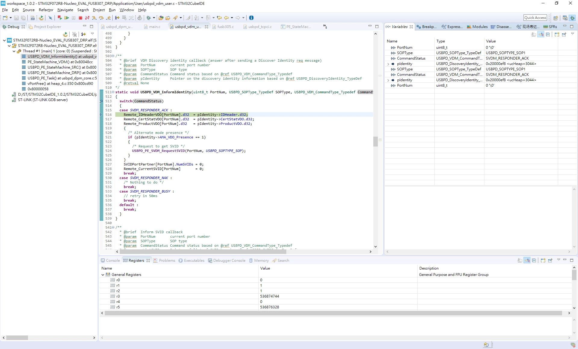

Yohann M.
November 5, 2019
Dear John,
In our stack, we check the content validity of the Discovery identity and we had an issue in this check (fixed in our latest delivery done for our G0 series). I updated the lib used in your environment. Could you please try it and let me know if it works or not? (I tested in my side, it should be OK ;) )
Regards
Yohann

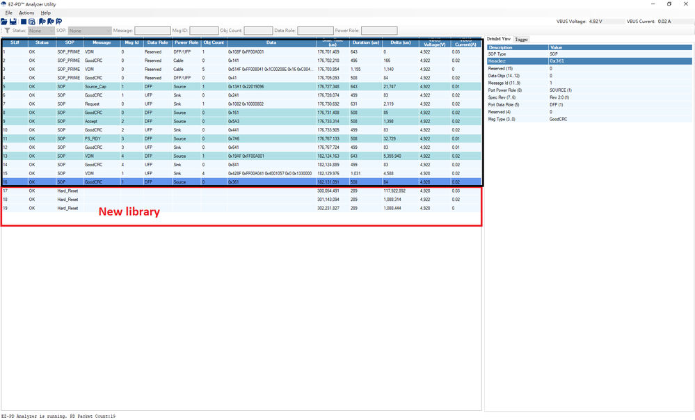

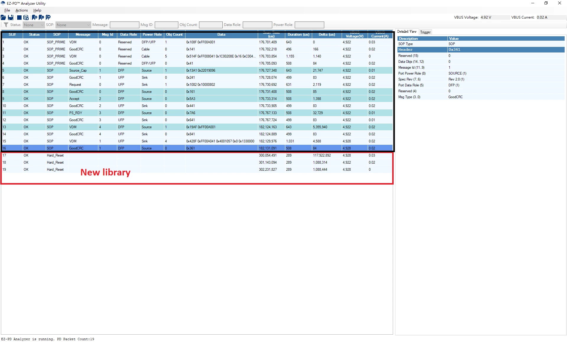

I used the library you uploaded yesterday, the weird thing happened.
The block in black is the old library that x-cude pd provide and the block in red is the new library you provided.
when i used the new library.
After receiving the hard reset sent by the fusb307evb , mcu hanged on the hard fault
Could you please provide the project that worked well in your side.
Thanks.
BR.
John
Yohann M.
November 7, 2019
Dear John,
Library I delivered is a library to be used on IAR or SW4STM32 (*_wc32.a libs).
For Keil, you should use *_keil.lib libs.
Please use the attached zip file in which one the lib for keil is available.

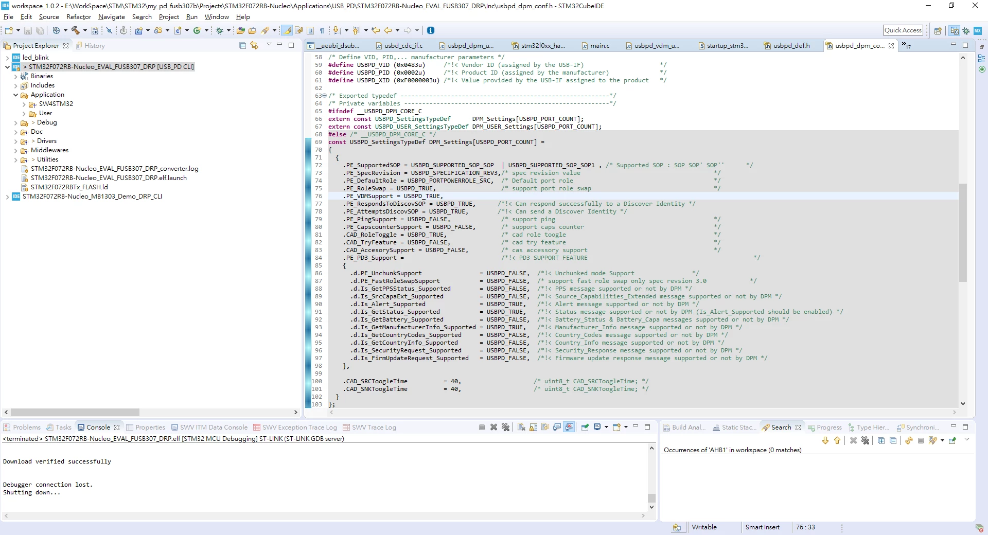

And i also want to report the issue when i test the MB1303_Demo_DRP_CLI.
  1. If i want to enable the Vconn support not only define the _VCONN_SUPPORT but also _APPLI_VCONN_SUPPORT.
  2. I set the sop and sop_1 support in the usbpd_dpm_conf.h but when PE stack calls the USBPD_PHY_Init it just sets the SupportedSOP to sop.
Thanks.
