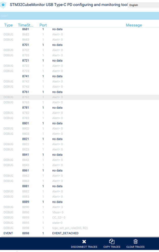

When I have traces functioning at build time and the system is acting as a source, if I pull the plug, the program may not respond to anything after that.
Pulling the plug when the trace is off and when the system is acting as a sink will not cause any problems.

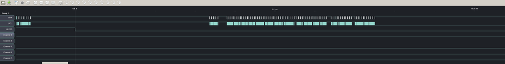

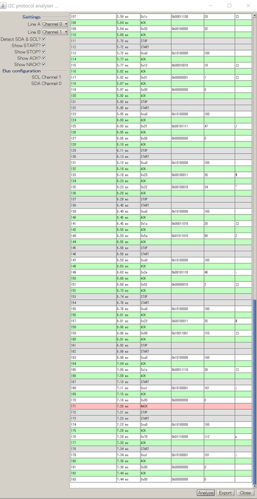

The last I2C communication record.
Immediately after an attempt to access the 0x70(VBUS_VOLTAGE_L) register, the system stops responding.The alert has been on LOW ever since.

I proceeded with the analysis.
This happens right after the PE task has finished.
I suspect that this is the trouble with the I2C peripherals' exclusive control.
After the cable detaches, the Alart task terminates the PE task. If the PE task is in the middle of accessing I2C at that time, it will exit with the I2C locked.
