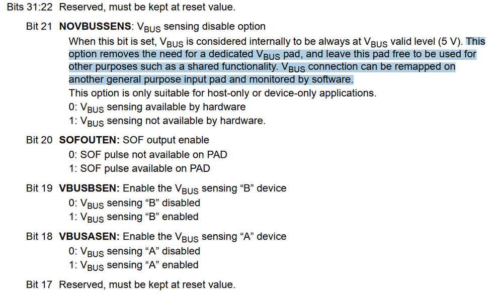

Is this some "library" like Cube? Then read the library's manual to find out how to avoid VBUS sensing. It's controlled by bits in GCCFG register which override any GPIO setting for PA9.

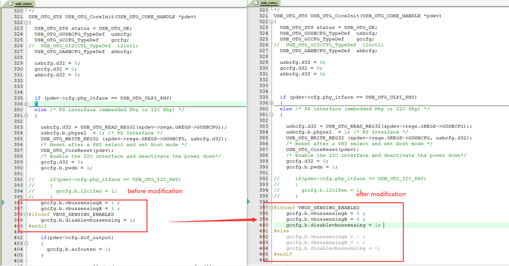

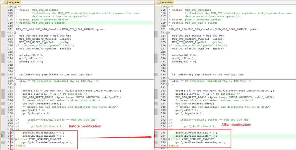

My USB library version is relatively old, not cube. Check the GCCGF register, there are two positions (NOVBUSSENS and VBUSASEN) that will affect VBUS. According to the register analysis, NOVBUSSENS controls whether the VBUS sense is valid; check the drive code NOVBUSSENS is set to 1, and VBUSASEN is also set to 1; According to the manual analysis, it should be that VBUS sense is invalid. In fact, PA9 still cannot be used as an input pull-up; try to set VBUSASEN to 0, PA9 can be used as an input pull-up.
If so, JW would you please help me analyze if there is a problem with my modification?
Anyway, thank you JW.
Modify the code:
GCCFG register:0693W000006Hf6mQAC.png

I don't know if your code is in any way dependent on the sense enabled by VBUSASEN, but quite likely it's not.
Setting GCCFG.NOVBUSSENS has the same effect than pulling VBUS pin high, regardless of GCCFG.VBUSBSEN. I'm not sure about VBUSASEN, but I'd be surprised if it would be different.

The board I use is self-powered and does not require VBUS sense. The program controls whether to turn on VBUS sense according to whether the macro VBUS_SENSING_ENABLED is defined; if the code is not modified, VBUSASEN is always 1, and the VBUS sense is controlled by NOVBUSSENS set to 1 or 0.
After communicating with you, I found a better modification method as follows.
