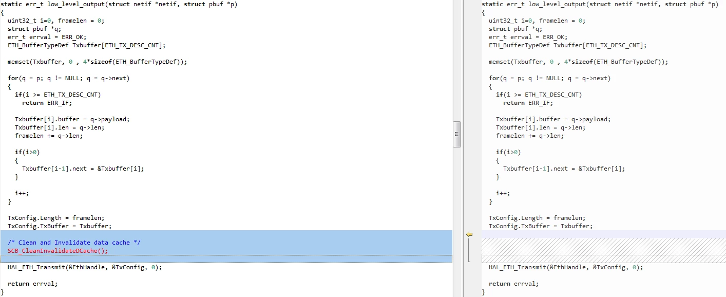

    STM32Cube_FW_H7_V1.2.0 ethernet sample is using DHCP, I want use static IP address. So I change the DHCP definition to 0 in lwipopts.h.
&sharpdefine LWIP_DHCP               0
    After comple the code and download to board, but I can not ping to board. What is wrong?
    Thanks.
#stm32h7-ethernet #stm32h
Best answer by Yi Zhou
Posted on July 04, 2018 at 16:55
Dear all:
    I found
STM32Cube_FW_H7_V1.1.0 lwip sample(LwIP_HTTP_Server_Netconn_RTOS) can run correctly in the board. So after compare the different between this two project, I finally find
STM32Cube_FW_H7_V1.2.0 lwip sample code bug.
    In ethernetif.c function low_level_output(), you MUST add the following code (bold font)
/* Clean and Invalidate data cache */
SCB_CleanInvalidateDCache();
HAL_ETH_Transmit(&EthHandle, &TxConfig, 0);
then sample can run correctly in the board.

I only disable DHCP future and set the correct static ip address. RTOS is actived. Nothing else changed. But the sample code can not work correctly.
    You can see the detail in the following picture.
July 4, 2018
Posted on July 04, 2018 at 17:21
You are right. This problem is reproduced with STM32CubeH7 V1.2.0, and not with previous versions as the cleaning/invalidating the cache manner has changed starting from V1.2.0.
So, adding a call of SCB_CleanInvalidateDCache() in low_level_output() function (as done in version V1.1.0 nor V1.0.0) resolves the issue. This call is removed in Version 1.2.0.
Our development tool team is aware about this issue and should fix this limitation in the coming release.
Thank you for reporting us the issue and we apologize for any inconvenience this may have caused you.
