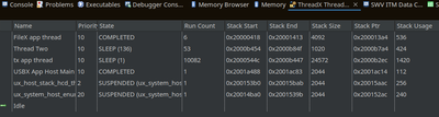

2024-09-20 5:29 AM
Just : i dont get this working:
@STea : Also, in CubleIDE you can find the extension for viewing ThreadX threads memory semaphores Stack usages and other related information using the Serial wire viewer feature.
But (for me) : stack usage shows nothing:
What i have to do, to see it ?
2024-09-20 6:10 AM
Stack usage for me also shows nothing, what I was previously doing to check for potential errors was looking at the Stack Start and Stack End and the Stack Ptr - checking to see the Stack Ptr was within said range. You can only do this on break points so in all this was not very effective. Yes it would be nice to see stack usage here - I guess that would be a type of water mark.
2024-09-20 7:37 AM

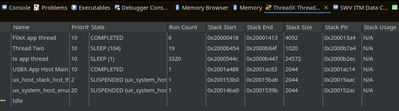

Hello @AScha.3 ,
check this video minutes 26 (284) MOOC - Azure RTOS workshop - 5 ThreadX lab - step1 - First thread creation - YouTube
you need to click on green table on the right corner to enable it.
Regards
2024-09-20 7:45 AM - edited 2024-09-20 9:22 AM
Thanks @STea ,
this click was the secret. Now :
Great !
