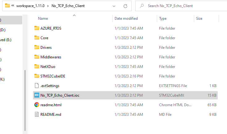

I WAS able to get one project to run, and it DID communicate with VCOM port. Here is the example file structure of the working project.

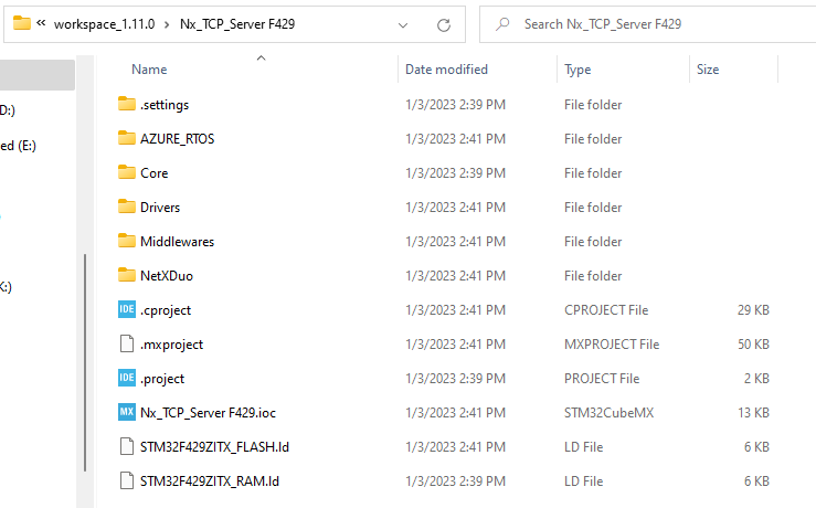

0693W00000Y7JxWQAV.pngBut below is a typical file structure (generated by CubeIDE). This project does NOT work, nor does it communicate with the VCOM port.
0693W00000Y7JyZQAV.pngNotice that the working file structure has a STM32CubeIDE folder, but the non-working project does not.

Pavel A.
January 4, 2023
It's hard to tell what is wrong in the generated project without debugging. But [more often than not] cube-generated projects do not work as is, need some manual adjustment.
So it is recommended to always start from a ready example rather than generate from scratch.
