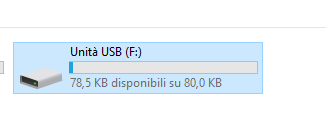

I replicated the same issue with the NUCLEO-U545RE-Q using RAM instead of SDcard.
With Windows 10 work fine

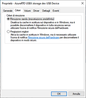

 With Windows 11
Thanks

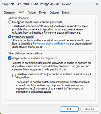

Windows 11 storage driver is set by default in QUICK REMOVAL. In this mode usbx doesn't work.
If i set policy in BETTER PERFORMANCE, usbx work fine.
Can you help me how to setting automatically this policy? Do i need a driver or something?
