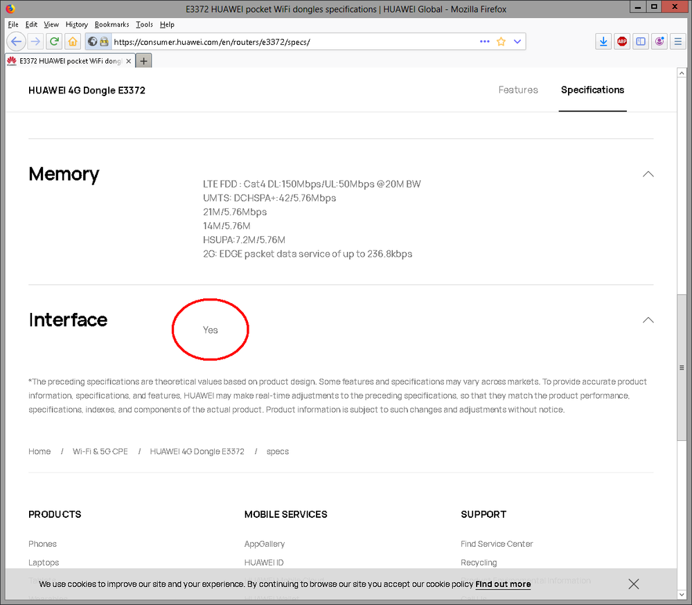

Hi, I have to interface with an internet stick for example Huawei E3372-153, is there a reference project?

waclawek.jan
May 31, 2020
Almost certainly no.
Is it a "well known" USB class, or vendor-specific? In the latter case, you are out of luck, in the former, it's still not very probable you could use it.
Observe the descriptors (device, configuration) e.g. using lsusb after you connect the stick to a Linux machine.

waclawek.jan
May 31, 2020
This is what the manufacturer had to say in this regard, verbatim:
Zanon.Luciano
June 1, 2020
Thanks to you for your quick answers.
Without a reference project, the way of optimizing the use of the internet key directly from the microprocessor becomes rather complex.
So at the moment I give up this optimization and I'm going to use a Raspberry for it.
