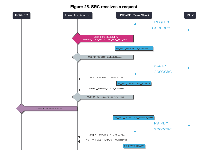

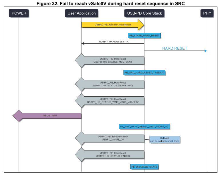

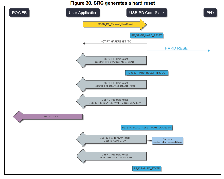

- In 4.3.4 figure 30, when SRC generates a hard reset, why is this the same as figure 32, Fail to reach vSafe0V during hard reset sequence in SRC? I suppose the final state when SRC generates a hard reset should be returning to Vsafe5V and resend capabilities?

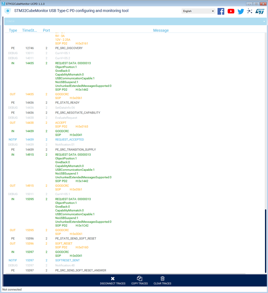

- This is the old question not yet answered, I just move it here, both NOTIFY_POWER_STATE_CHANGE and USBPD_PE_RequestSetupNewPower should have been called after PE_SRC_TRANSITION_SUPPLY as shown in Fig. 25 , but in my case nothing is happened, so what am I missing here?

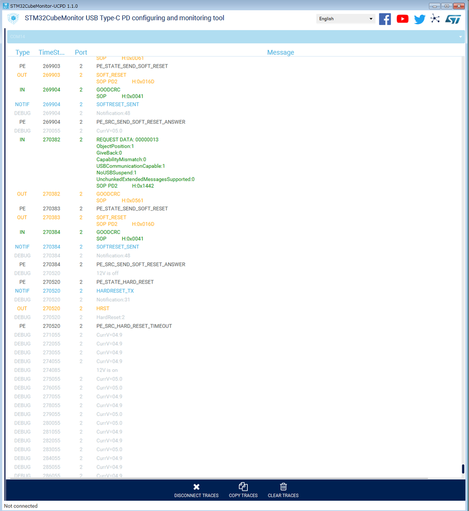

- Again another moved unanswered question, when my board as a source generates a hard reset , no USBPD_HR_STATUS_START_REQ callback is received after PE_SRC_HARD_RESET_TIMEOUT as shown in fig 30.

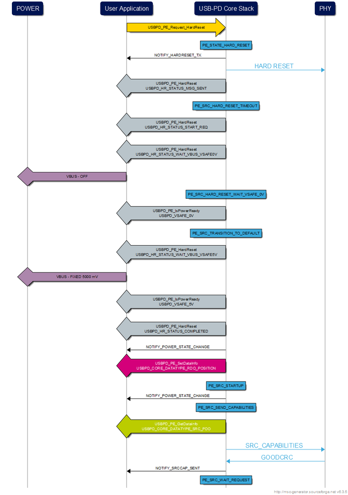

Question 1 : yes this is an error in our documentation, see below the right MSC
Question 2 : the trace is really strange because you started the MSC of power negotiation however the SINK is still sending REQUEST which is broken the MSC sequence and it is why NOTIFY_POWER_STATE_CHANGE and USBPD_PE_RequestSetupNewPower call never happen
Please could you send me the trace file ? it must be available inside this folder c:\Users\user_name\AppData\Local\Temp\STM32CubeMonitor-UCPD\Acquisition\2019_07_29_15_41_57_USBCPD_Debug_File.cpd
Question 3 : I don't understand the issue it is like PE is no more running or an issue with our internal timer. please could you send me the trace i will check deeper ?
The sink behavior is really strange, please could you share what is the material used as sink ?
