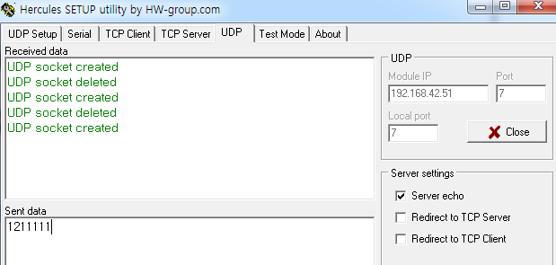

I sent the message using Hercules tool. but Necleo didn't receive massages .

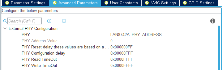

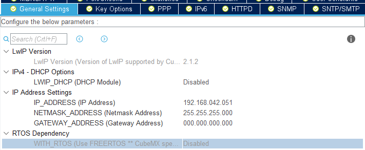

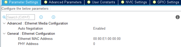

there are CubeMX setting value.
I also change GATEWAY ADDRESS to 192.168.42.1, not working too.
/* lwIP.c*/
void MX_LWIP_Init(void)
 /* IP addresses initialization */
	 	IP_ADDRESS[0] = 192;
		IP_ADDRESS[1] = 168;
		IP_ADDRESS[2] = 42;
		IP_ADDRESS[3] = 51;
		NETMASK_ADDRESS[0] = 255;
		NETMASK_ADDRESS[1] = 255;
		NETMASK_ADDRESS[2] = 255;
		NETMASK_ADDRESS[3] = 0;
		GATEWAY_ADDRESS[0] = 0;
		GATEWAY_ADDRESS[1] = 0;
		GATEWAY_ADDRESS[2] = 0;
		GATEWAY_ADDRESS[3] = 0;

​I want to work udp_echoserver_receive_callback fuction when I send a message.
Best answer by Piranha
You are calling udp_echoserver_init() before MX_LWIP_Init(). :)

BPark.4
BPark.4Author
May 4, 2020
Thank you.
I modifed it under MX_LWIP_Init(). and I can receive the message.
