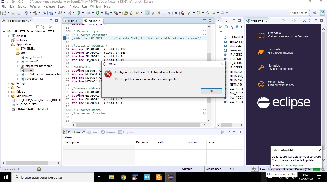

0693W000004JxdaQAC.pngHi Mirza,
I´m trying run the the LwIP example in my board STM32F429ZI board. I following the steps:
1) In STM32CubeMX I selected the board STM32F429ZI and the example LwIP_HTTP_Server_Netconn_RTOS, using example selector. I export and import the project to a SW4STM32 workspace.
2) I can compile the project without error, but when I tryied run it I got the following error:
Configure inet adress 'Not IP fond' is not reachable
Please update correspondenting debug Configuration.
Did you get this error? Could you please, help me?

First of all I used STM32CubeIDE and not SW4STM32. But that shouldn't be a problem I hope. STM32CubeMX is integrated with the STM32CubeIDE and in there I chose Nucleo-F429ZI instead of the IC itself, STM32F429ZI. That will automatically initialize the required peripherals for that board.
Did you read the "readme.txt"?
How are you communicating with the PC from Nucleo Board? Directly (using crossover ethernet cable) or through router (using straight ethernet cable)?
Are you configuring a static IP address for your PC?
