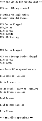

I want to test the read and write speed of U5 on the USB flash drive. I have made modifications to the demo (STM32U5G9J-DK2 \ Applications \ USBX \ Ux_Host_HUB_HID_MSC) so that I can observe the read and write speed.
#define MASS_TEST_WR_LEN (64*1024)
#define MASS_TEST_LEN (ULONG64)(64*1024*1024)
But when I write data in 64MByte, there is a transmission timeout issue.
How should I solve this problem?
thanks!

update:
If I enabled USB DMA, then this problem wouldn't have occurred, but why is that?
hhcd_USB_OTG_HS.Init.dma_enable = ENABLE;

   I also tested the situation without a hub, and the same amount of data can be written into the USB drive without any errors. Can this indicate that the throughput is sufficient?

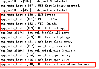

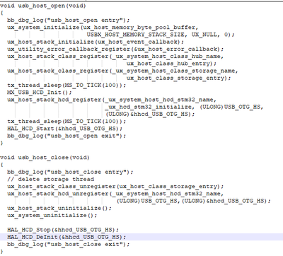

   Due to project requirements, it is necessary to reinitialize the USB after the device is connected. Enabling DMA will cause the HUB enumeration to fail, and the same error code is 0x5C. But the first enumeration can be successful. Can you help me review it?

Hi @Xiang
If it is connected to High-Speed Upstream port, then it operates in HS mode. Otherwise, it operates in FS and narrows down the throughput.
Could you please confirm that the Hub you are using is self-powered? If not, this could be linked to amount of power sourced by DK board.
When using DMA, could you try to add this condition here
 if ((USBx == USB_OTG_HS) && (hc->speed == USBH_HS_SPEED))
To give better visibility on the answered topics, please click on "Best answer" on the reply which solved your issue or answered your question.Best regards,FBL
