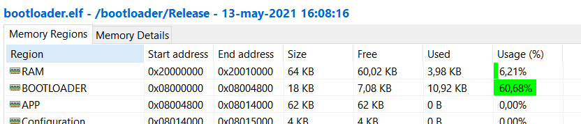

I dont know if this is your problem but:
In my case the bootloader is located at the beginning of my flash so is executed after reset, and after 1 second of no booting action it jumps to my programm code.
Does STM32L031 familly have a dynamically allocated vector table?
found in my file system_stm32f1xx.c :
/* Note: Following vector table addresses must be defined in line with linker
         configuration. */
/*!< Uncomment the following line if you need to relocate the vector table
     anywhere in Flash or Sram, else the vector table is kept at the automatic
     remap of boot address selected */
#define USER_VECT_TAB_ADDRESS
#define VECT_TAB_BASE_ADDRESS   FLASH_BASE      /*!< Vector Table base address field.
                                                     This value must be a multiple of 0x200. */
#define VECT_TAB_OFFSET         0x00004800     /*!< Vector Table base offset field.
//my program code starts at flash addr 0x80004800

My jumptoAPP function from the bootlodaer looks like this;
void jumpToApp(const uint32_t address) {
	const JumpStruct *vector_p = (JumpStruct*) address;
	deinitEverything();
	/* let's do The Jump! */
	/* Jump, used asm to avoid stack optimization */
	asm("msr msp, %0; bx %1;" : : "r"(vector_p->stack_addr), "r"(vector_p->func_p));
