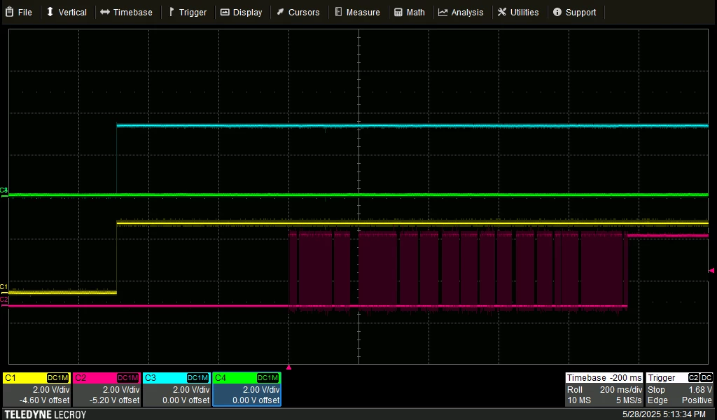

Furthermore, I'm using test point on PCB to monitor the activation of the USB interfaces (CDC and MSC) and use pins to track read write operations on the MSC interface.
The patterns look very similar for IT and DMA driven communication.
IT driven:
DMA driven:

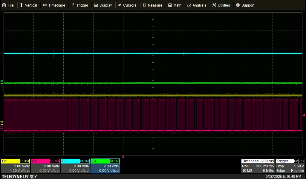

In case of the IT driven approach, the reading activity completely stops once Windows has mounted the drive. In case of the DMA, the access continues indefinitely:
So, after a few days of searching, I was wondering if anyone can spot an issue with this setup or if there is any errata which I missed regarding the UsbX / SDMMC / DMA on the STM32H7.

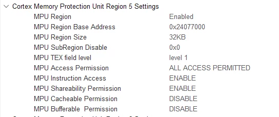

For a future reference, after digging for a very long time, I finally found the issue causing the SDMMC DMA to fail silently and corrupting the SD card. And of course it was a MPU configuration / cache consistency problem :(
In the first post I provided the USBX pool memory region definition at the address 0x24077000 with length 32K:
/* Specify the memory areas */
MEMORY
 USB_D1 (xrw)			: ORIGIN = 0x24077000, LENGTH = 32K
Configuring the MPU for this address and length does not work properly as according to ARM, the MPU region base address must be aligned to the region size:
DZimm9_0-1756886979195.pnghttps://developer.arm.com/documentation/dui0646/c/Cortex-M7-Peripherals/Optional-Memory-Protection-Unit/MPU-Region-Base-Address-Register
This is a very important bit of information, which I have not found in any STM documentation / application notes... it  might be even wise to add this check to the CubeMX MPU configuration tool to throw a warning when the address is misaligned to the region size.
