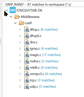

Hi Again ST
I ran traced the program flow of MX_LWIP_Init() to determine where things were going wrong.  It didn't take long to find as the error occurs in the  tcpip_init( NULL, NULL );  function in the tcpip.c file function lwip_init(void) and more precisely in the udp_init() function. This may be found in file udp,c,
/** * Initialize this module. */ #pragma GCC push_options #pragma GCC optimize ("O0") void udp_init(void) { #ifdef LWIP_RAND uint32_t randNo = LWIP_RAND(); /* <== Fails in the rand function rjg debug */ udp_port = UDP_ENSURE_LOCAL_PORT_RANGE(LWIP_RAND()); #endif /* LWIP_RAND */ } #pragma GCC pop_options
The call to the stdlib, rand() function fails at the assert function:
rand: 90033524: ldr r3, [pc, #88] @ (0x90033580 <rand+92>) 90033526: push {r4, lr} 90033528: ldr r4, [r3, #0] 9003352a: ldr r3, [r4, #48] @ 0x30 9003352c: cbnz r3, 0x9003355c <rand+56> 9003352e: movs r0, #24 90033530: bl 0x900333a8 <malloc> 90033534: mov r2, r0 90033536: str r0, [r4, #48] @ 0x30 90033538: cbnz r0, 0x90033544 <rand+32> 9003353a: ldr r3, [pc, #72] @ (0x90033584 <rand+96>) 9003353c: ldr r0, [pc, #72] @ (0x90033588 <rand+100>) 9003353e: movs r1, #82 @ 0x52 90033540: bl 0x90033360 <__assert_func> ;<== Fails here program hangs no hard fault 90033544: ldr r1, [pc, #68] @ (0x9003358c <rand+104>) 90033546: ldr r3, [pc, #72] @ (0x90033590 <rand+108>) 90033548: strd r1, r3, [r0] 9003354c: ldr r3, [pc, #68] @ (0x90033594 <rand+112>) 9003354e: str r3, [r0, #8] 90033550: movs r3, #11 90033552: strh r3, [r0, #12]
The program ends in the while(1) loop in syscalls
void _exit (int status) { _kill(status, -1); while (1) {} /* Make sure we hang here */ }
This is weird so I tried the rand function in main.c. and it worked.
I call the MX_LWIP_Init from the default task that i renamed monitorTask so I checked the stack assignment, it was only 128 words so I increased it to 4096 thinking it might be a stack problem. This didn't fix the problem.  I looked at the heap allocation as rand calls malloc.  My heap in FreeRTOS is set to 100000 and the system heap set in the linker script is 0x1000 (4k) which seems OK.
The rand function is not guaranteed thread safe so i disabled interrupts before ran is called, but it still failed at the
_exit function.
I removed the call to rand and made the number a constant 0xCOAD1234. Viz.
/** * Initialize this module. */ #pragma GCC push_options #pragma GCC optimize ("O0") void udp_init(void) { #ifdef LWIP_RAND taskDISABLE_INTERRUPTS(); // uint32_t randNo = LWIP_RAND(); /* rjg debug */ // udp_port = UDP_ENSURE_LOCAL_PORT_RANGE(59876); udp_port = 59876; taskENABLE_INTERRUPTS(); #endif /* LWIP_RAND */ } #pragma GCC pop_options
This fixed the call to udp_init, but then the program crashed on the following call to tcp_init on the same macro:
void tcp_init(void) { #ifdef LWIP_RAND tcp_port = TCP_ENSURE_LOCAL_PORT_RANGE(LWIP_RAND()); #endif /* LWIP_RAND */ }
I replaced the call to rand with a fixed value:
void tcp_init(void) { #ifdef LWIP_RAND // tcp_port = TCP_ENSURE_LOCAL_PORT_RANGE(LWIP_RAND()); tcp_port = 59123; #endif /* LWIP_RAND */ }
This allowed the tcp_init function to complete without crashing, but sadly something else went wrong in the DHCP module in the dhcp_discover function. And yes, you guessed it, the lead in the saddlebags was our old friend rand(), line 1913 of the dhcp,c module! viz:
/* DHCP_REQUEST should reuse 'xid' from DHCPOFFER */ if ((message_type != DHCP_REQUEST) || (dhcp->state == DHCP_STATE_REBOOTING)) { /* reuse transaction identifier in retransmissions */ if (dhcp->tries == 0) { #if DHCP_CREATE_RAND_XID && defined(LWIP_RAND) xid = LWIP_RAND(); /* <== ****************** This one **********/ #else /* DHCP_CREATE_RAND_XID && defined(LWIP_RAND) */ xid++; #endif /* DHCP_CREATE_RAND_XID && defined(LWIP_RAND) */ } dhcp->xid = xid; } LWIP_DEBUGF(DHCP_DEBUG | LWIP_DBG_TRACE, ("transaction id xid(%"X32_F")\n", xid));
I did a search for LWIP_RAND and found it is sprinkelrd liberally around the LWIP code:
That's it for now it is lunch time.
I will make my own rand code and tackle the problem on a full stomach. Fixing this is not for the mal-nourished!
