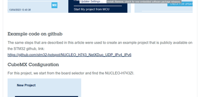

Hello @Kubagrs
Please refer to this example which is generated using the same steps described in the article.
In order to give better visibility on the answered topics, please click on 'Best answer' on the reply which solved your issue or answered your question. Saket_Om
