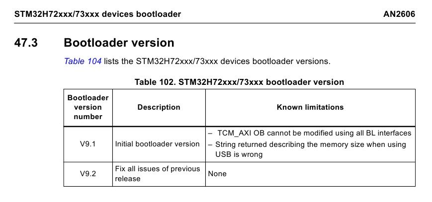

Write memory and Erase memory commands run correct. A program in flash memory mode (BOOT0 pin LOW) run correct. There are no limitations in AN2606:

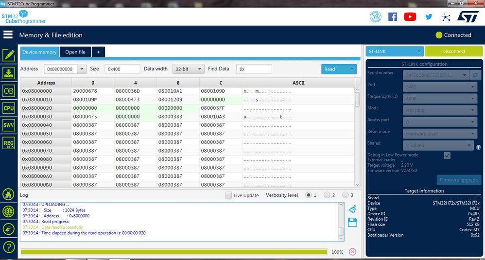

0693W00000FAPgWQAX.jpgI tried to run the debugger on the STM32H723 (device side). I stop the program, and after the command GO I start it again in step mode. After of several steps disconnection occurs:
0693W00000FAQMNQA5.jpgFlash in STM32H723:
0693W00000FAPgbQAH.jpgWhat am I doing wrong?
