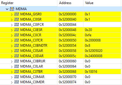

These are the MDMA registers when I enable the MDMA at step 5:

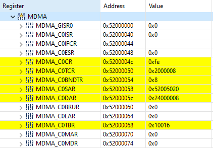

0693W00000LwRkuQAF.pngThese are the MDMA registers when I get the error interrupt at step 6:

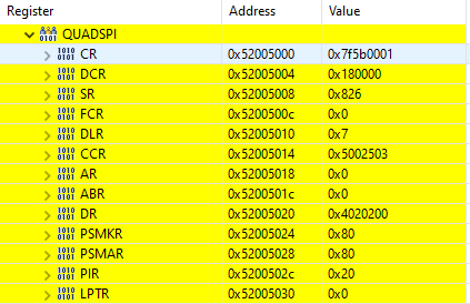

0693W00000LwRlYQAV.pngThese are the QUADSPI registers when I enable the MDMA at step 5:

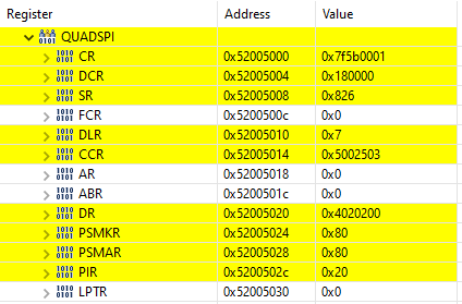

0693W00000LwRmqQAF.pngThese are the QUADSPI registers when I get the error interrupt at step 6:
0693W00000LwRnKQAV.pngI have tried adding various delays in case it is a timing issue but to no avail. I don't understand why I get the error.

The issue that caused the error was
MDMA_CxTBR_SBUS
Changing that from 1 to 0, and it no longer crashed. The other issue I faced which is why I though this was RTOS related was that the FreeRTOS variables shared the same memory in RAM as my local variables.
