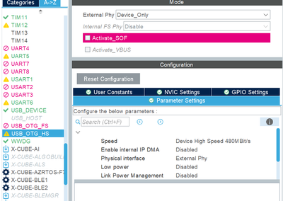

In case anyone else has this problem, I think I found a fix
The option 'Enable Internal IP DMA' must be disabled. The problem is not to do with buffer alignment as I checked this, it seems to be a timing issue and may be specific to the use of FreeRTOS.
Note that the option 'Use dedicated end point 1 interrupt' must also be disabled as that also prevents USB comms.

Hi @barryccl
Are you enabling "Internal USB DMA"? If you get some transfers, then it stalls, the issue may be linked to non-word aligned addresses.
‎2024-08-12 3:04 AM
Hi @FBL
I don't see DMA as an option in CubeMx - I guess it is mandatory for HS USB, but I believe I have word aligned buffers as I have replaced the auto-generated defs with:

‎2024-09-25 3:33 AM
