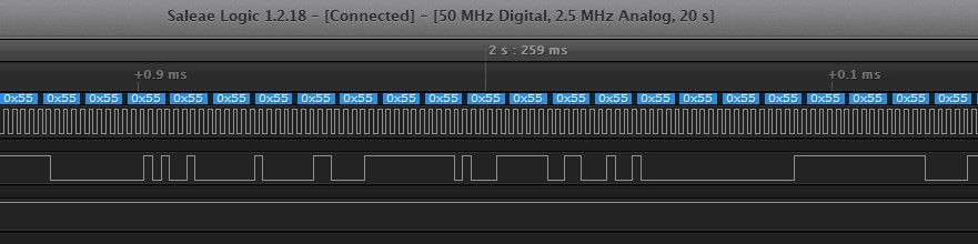

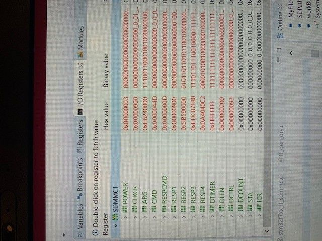

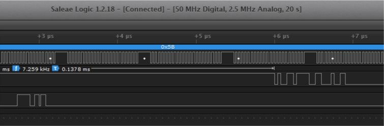

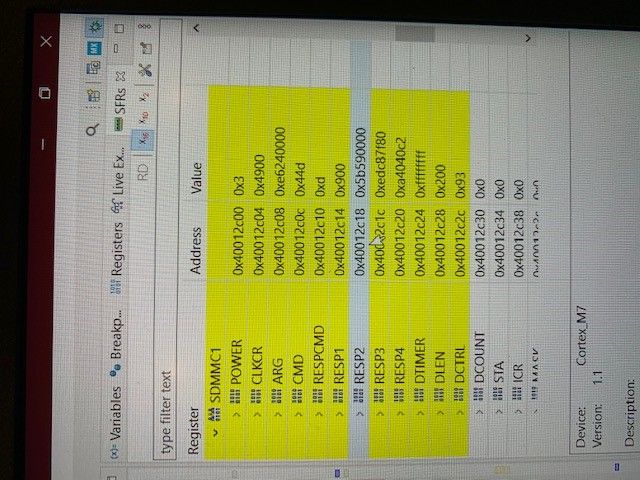

After a few days I solved the problem... It was a bit frustrating, because the "STM32Cube_FW_F7_V1.15.0\Projects\STM32746G-Discovery\Applications\FatFs\FatFs_uSD" worked every time on my STM32F746G-DISCO board with the uSD Card I had inserted, but everything else I tried failed. I watched all the YouTube videos and searched all the forums, but nothing worked. Finally, I decided to take a step back and create a project using the latest CubeIDE 1.5.0 with just the CD Card support, and compare all the applicable code to the example provided by STM in the CubeMX repository STM32Cube_FW_F7_V1.15.0. Everything matched and it still didn't work. So I decided to hook up my trusty logic/protocol analyzer to the SDMMC1 bus (at least the CK, CMD and one of the Data lines). This turned out to be the key to figuring out the problem. What I noticed is that, in the STM example the SDMMC1_CK signal stops toggling periodically, but in my generated code the SDMMC1_CK signal kept toggling continuously. This got me looking at the SDMMC1_CK configuration, but both configurations specify SDMMC hardware flow control = Enabled. Anyway, I decided to change that in my project and Whaaalllaaa!!!!!!!!!!!!!!!!!!!!!!! Now these settings were different, but it worked!!!!!!!!!!!!??????????????????????
STM example - Bus signals capture and SDMMC1 registers:
CubeIDE generated code - Bus signals capture and SDMMC1 registers:
I got my code to work now, but can someone explain this to me, please? =O
