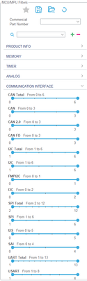

For the low power product, I suggest you to look for one of the MCUs in the following series (L0, L4, L4+, L5 and U5). You Can use the filters of CubeMX (MCU selector) to find the MCUs that match with your API needs.
For the ARM CORTEX R, We don't have any MCU that use this cortex.
PS: Ethernet is not supported on the Low power series.
