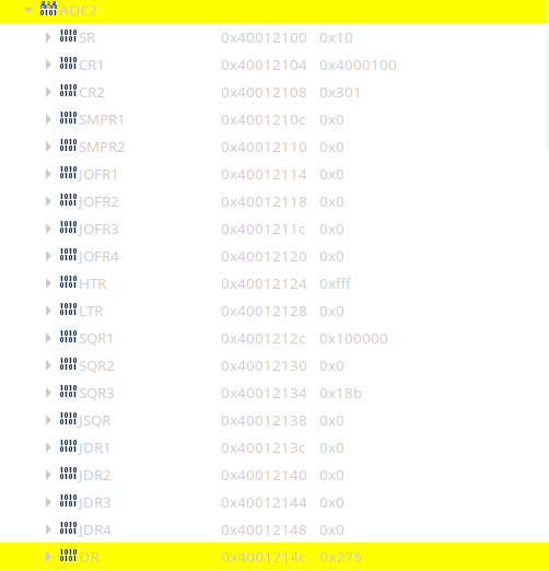

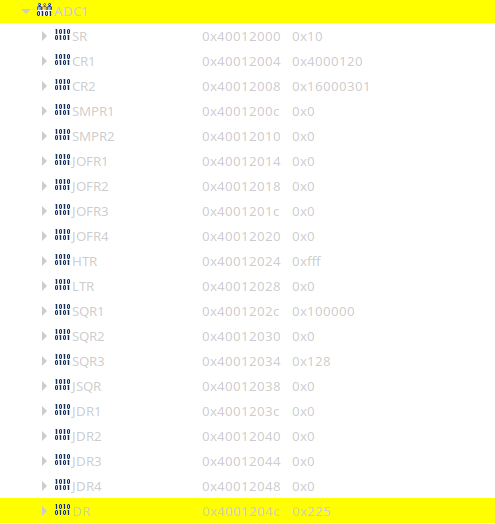

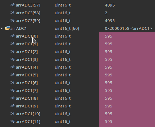

stm32f407 transfer the same ADC data several times
TAndr.1
I config ADC with DMA and TIM2. By TIM2 overflow starts ADC process for ADC1 ADC2 and ADC3 simultaneously. DMA collect ADC data and store to RAM. In debug i see that DMA for ADC1 transfer the same ADC data several times.
For example:
ADC1: 32, 32, 32, 32, 32, 32, 32 11, 11, 11, 11, 11
ADC2: 32, 11
ADC3: 32, 11
Problem not with ADC1. I arrange interrupt after end of conversion. It's interrupts by TIM2.
void HAL_ADC_MspInit(ADC_HandleTypeDef* hadc)
  if(hadc->Instance==ADC1)
	 memset(arrADC1, 0, ARR_LEN * sizeof(arrADC1[0]));
    __HAL_RCC_ADC1_CLK_ENABLE();
    __HAL_RCC_GPIOB_CLK_ENABLE();
    GPIO_InitStruct.Pin = GPIO_PIN_0|GPIO_PIN_1;
    GPIO_InitStruct.Mode = GPIO_MODE_ANALOG;
    HAL_GPIO_Init(GPIOB, &GPIO_InitStruct);
    hdma_adc1.Instance = DMA2_Stream0;
    hdma_adc1.Init.Channel = DMA_CHANNEL_0;
    hdma_adc1.Init.Direction = DMA_PERIPH_TO_MEMORY;
    hdma_adc1.Init.PeriphInc = DMA_PINC_DISABLE;
    hdma_adc1.Init.MemInc = DMA_MINC_ENABLE;
    hdma_adc1.Init.PeriphDataAlignment = DMA_PDATAALIGN_HALFWORD;
    hdma_adc1.Init.MemDataAlignment = DMA_MDATAALIGN_HALFWORD;
    hdma_adc1.Init.Mode = DMA_CIRCULAR;
    hdma_adc1.Init.Priority = DMA_PRIORITY_MEDIUM;
    hdma_adc1.Init.FIFOMode = DMA_FIFOMODE_DISABLE;
    if (HAL_DMA_Init(&hdma_adc1) != HAL_OK)
      Error_Handler();
    __HAL_LINKDMA(hadc,DMA_Handle,hdma_adc1);
    HAL_ADC_Start_DMA(hadc, (uint32_t *)arrADC1, ARR_LEN);

The code you linked does not initialize the ADC channels. This can be done with HAL_ADC_ConfigChannel calls in HAL.
It also doesn't call HAL_ADC_Init which I'm pretty sure is required.

static void MX_ADC1_Init(void)
  /* USER CODE BEGIN ADC1_Init 0 */
  //ADC1->CR1 |= ADC_CR1_EOCIE;
  /* USER CODE END ADC1_Init 0 */
  ADC_MultiModeTypeDef multimode = {0};
  ADC_ChannelConfTypeDef sConfig = {0};
  /* USER CODE BEGIN ADC1_Init 1 */
  HAL_NVIC_SetPriority(ADC_IRQn, 4, 0);
  HAL_NVIC_EnableIRQ(ADC_IRQn);
  /* USER CODE END ADC1_Init 1 */
  /** Configure the global features of the ADC (Clock, Resolution, Data Alignment and number of conversion)
  hadc1.Instance = ADC1;
  hadc1.Init.ClockPrescaler = ADC_CLOCK_SYNC_PCLK_DIV4;
  hadc1.Init.Resolution = ADC_RESOLUTION_12B;
  hadc1.Init.ScanConvMode = ENABLE;
  hadc1.Init.ContinuousConvMode = DISABLE;
  hadc1.Init.DiscontinuousConvMode = DISABLE;
  hadc1.Init.ExternalTrigConvEdge = ADC_EXTERNALTRIGCONVEDGE_RISING;
  hadc1.Init.ExternalTrigConv = ADC_EXTERNALTRIGCONV_T2_TRGO;
  hadc1.Init.DataAlign = ADC_DATAALIGN_RIGHT;
  hadc1.Init.NbrOfConversion = 2;
  hadc1.Init.DMAContinuousRequests = ENABLE;
  hadc1.Init.EOCSelection = ADC_EOC_SEQ_CONV;
  if (HAL_ADC_Init(&hadc1) != HAL_OK)
    Error_Handler();
  /** Configure the ADC multi-mode
  multimode.Mode = ADC_TRIPLEMODE_REGSIMULT;
  multimode.DMAAccessMode = ADC_DMAACCESSMODE_1;
  multimode.TwoSamplingDelay = ADC_TWOSAMPLINGDELAY_5CYCLES;
  if (HAL_ADCEx_MultiModeConfigChannel(&hadc1, &multimode) != HAL_OK)
    Error_Handler();
  /** Configure for the selected ADC regular channel its corresponding rank in the sequencer and its sample time.
  sConfig.Channel = ADC_CHANNEL_8;
  sConfig.Rank = 1;
  sConfig.SamplingTime = ADC_SAMPLETIME_3CYCLES;
  if (HAL_ADC_ConfigChannel(&hadc1, &sConfig) != HAL_OK)
    Error_Handler();
  sConfig.Channel = ADC_CHANNEL_9;
    sConfig.Rank = 2;
      Error_Handler();
  /* USER CODE BEGIN ADC1_Init 2 */
  /* USER CODE END ADC1_Init 2 */
  * @brief ADC2 Initialization Function
  * @param None
  * @retval None
static void MX_ADC2_Init(void)
  /* USER CODE BEGIN ADC2_Init 0 */
  /* USER CODE END ADC2_Init 0 */
  /* USER CODE BEGIN ADC2_Init 1 */
  /* USER CODE END ADC2_Init 1 */
  hadc2.Instance = ADC2;
  hadc2.Init.ClockPrescaler = ADC_CLOCK_SYNC_PCLK_DIV4;
  hadc2.Init.Resolution = ADC_RESOLUTION_12B;
  hadc2.Init.ScanConvMode = ENABLE;
  hadc2.Init.ContinuousConvMode = DISABLE;
  hadc2.Init.DiscontinuousConvMode = DISABLE;
  hadc2.Init.DataAlign = ADC_DATAALIGN_RIGHT;
  hadc2.Init.NbrOfConversion = 2;
  hadc2.Init.DMAContinuousRequests = ENABLE;
  hadc2.Init.EOCSelection = ADC_EOC_SEQ_CONV;
  if (HAL_ADC_Init(&hadc2) != HAL_OK)
    Error_Handler();
  sConfig.Channel = ADC_CHANNEL_11;
  sConfig.Rank = 1;
  if (HAL_ADC_ConfigChannel(&hadc2, &sConfig) != HAL_OK)
    Error_Handler();
  /* USER CODE BEGIN ADC2_Init 2 */
  sConfig.Channel = ADC_CHANNEL_12;
	sConfig.Rank =2;
	  Error_Handler();
  /* USER CODE END ADC2_Init 2 */

On picture - in arrADC3 - data from two adc channels. It OK. But in arrADC1 - repeated data from only one channel!0693W000000Wb07QAC.png
waclawek.jan
Read out and post content of ADC and DMA registers.
TAndr.1
0693W000000WcUSQA0.png0693W000000WcUNQA0.png0693W000000WcUIQA0.png0693W000000WcUDQA0.png
