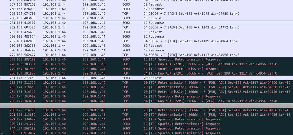

I have configured STM32 as a server using tcp_echoserver example. I'm receiving data through tcp_echoserver_revc() function.
I'm receiving packets in this way: #INIT*
When STM32 receive X packets (Around 14), it stops receiving data and TCP connection disconnects from PC. However, STM32 still working normally (except lwip part). It can't receive or send any packet.
All configuration is by default, IP fixed.
This is a capture from wireshark. 192.168.1.40 is the IP of STM32. When STM32 fails, black lines appear.
As I say, it is all by default. I have only modified tcp_echoserver.c file. I write below functions that belongs to that file.

I have use tcp_echoserver.c file by default, adding these lines in order to save data into a buffer, it works fine. However, it's always making echo.
 memcpy(&BufferAux,p->payload,p->len);
 pos = 0;
 	while (pos < p->len){
 		BufferETH[BuffPosIn_ETH++] = BufferAux[pos++];
 		if (BuffPosIn_ETH >= sizeof(BufferETH))
 			BuffPosIn_ETH = 0;
 	memcpy(&BufferAux,0,sizeof(BufferAux));
Anyone can help me? Thanks.

In my case, I think there's a buffer or memory problem, but I can't find it.

did you fix the issue??? I  have a very similar issue: after 16 commands, stm32 only queues commands
I use LWIP on a STM32H7 custom board.
I send command from a PC using Hercules
I use TCP, my stm32 is a server
Board receives commands and parses them out.
After I sent 16 commands, on the 16th command, pbuf_chain is called. On the first 15 commands tcp_server_handle is called.
I use the example in
https://controllerstech.com/stm32-ethernet-4-tcp-server/
I have MEMP_NUM_PBUF set to 16 and MEMP_NUMTCP_SEG set to 16. Tried to increase these parameters, didn’t help.
  • First time Isend a command of 7 bytes, Hercules gets response of 12 bytes (from stm32 board, no issue here)
  • Then send command CmdA of 102 bytes, Hercules gets response of 12 bytes, no issue here.
  • Then send another command CmdB of 102 bytes, Hercules  gets response of 12 bytes, no issue here.
  • Send command 7 bytes, Hercules Hercules gets response of 12 bytes
15)  Then send command CmdA of 102 bytes, Hercules gets response of 12 bytes, no issue here.
16) send command CmdB of 102 bytes, STM32 does not respond but command is put in a chain (pbuf_chain is called in tp_server_recv)
Why the 16th command is queued in the chain and not processed.
thanks
