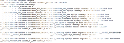

I download recently the last release of Stm32cubeF4 v1.28 and I have the MDK V5.38 installed in my machine, so normally I was expecting that examples will build out of the box but it's not the case.
It looks like the project example provided are working only in older version of MDK, I try to change some settings but the compiler version it's not even the same, and I end up with a mess.

These steps that you mentioned I have already done them, when I figure out that the compiler used now is ArmClang but still I end up with the following error message for each single file compiled :
This just the build of simple example on the target STM32F4-Discovery, maybe I miss something

What are the errors you're getting?
It's easy enough to switch to the Version 6 compiler, and Version 5 used to be in a download package.
As I recollect it MDK 5.38 needs to pull packages if it needs them. And you might have to remove a command line option for C99 and check the checkbox item for it instead.
‎2024-06-19 12:28 PM
Looks to be because of a divergent version of CMSIS, would suggest the project contemporary version from the HAL directories. Let it pull F4 pack, selected Default V6, checkboxed C99

I just reinstall MDK again and load gain all needed packs, STM32F4, CMSIS,... with this my problem is solved my, the only explanation that I could found is maybe loading a lot of packs from different vendors it's not a good idea.

If you touch the target setting, picking an MCU, I think it associates with the CMSIS in the pack(s), which is likely several versions newer than anything ST is shipping
