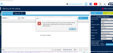

October 23, 2024
i have the same issue i used the STM32CubeProgrammer but is not connecting please help me

Hi,i had the same question,after i used STlink-V2 to connected my a custom board,i could not connected my chip(stm32f407ZE) anymore.it looked like RDP(read out protection) level 2,I tryed to pull up BOOT to high but it is Invalid。the error also is:
Can not connect to target!
Please select "Connect Under Reset" mode from Target->Settings menu and try again.
If you're trying to connect to a low frequency application , please select a lower SWD Frequency mode from Target->Settings menu.
in two months,this error had cause my 5 boards bircked.programes is disappeared.the chip could do nothing.
If your MCU is at RDP level 2, it's no more recoverable. So need to replace or use another MCU.
